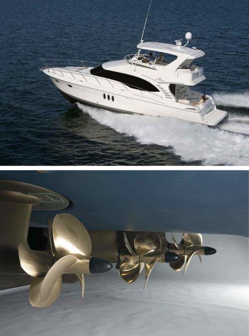

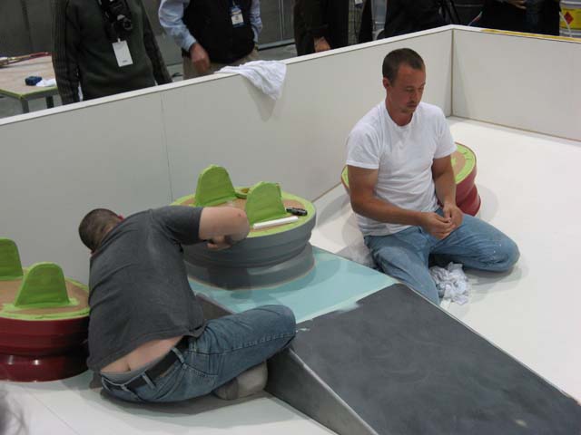

  10. YachtForums
    20,951
    Just to clarify...
    Volvo established a facility in Chesapeake, VA last year specifically to help boat builders incorporate the IPS system into existing and new hull types. For single or triple installations, a special insert is molded into the hull. I attended a press conference at this facility while a triple-mold was being faired. I have some pics of the event, including a shot under the hull of a triple rig installation, but can't seem to find 'em. Will post upon discovery.
  11. AMG
    5,392
    From what I was told, the center drive needs some kind of tunnel modification of the hull. All IPS drives can use an insert to facilitate the installation.
  12. YachtForums
    20,951
    That's correct Lars. Here's a pic of that triple IPS mold insert during the fairing process...

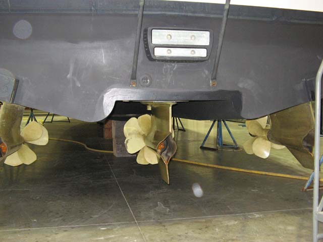

  13. YachtForums
    20,951
    And here's a pic of the triple-IPS installation...
