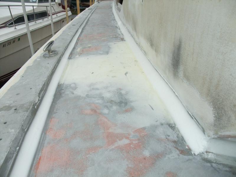

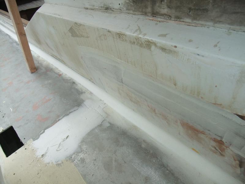

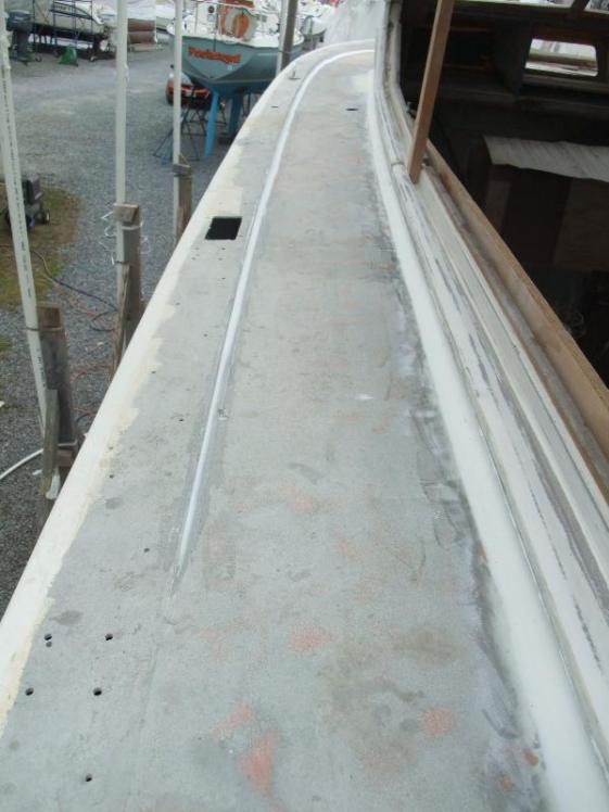

    located other Roamers
    Yes it did take me a bit to get to the Roamer section. Thanks for the pictures.

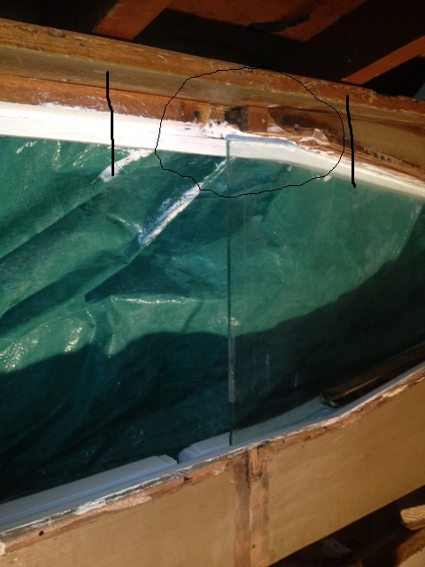

    window leak on Starboard
    This is the place that I see the water damage, on the starboard side above the first window/cabin support, above the actual window pane. It appear to me that , (we have rain here in IL and a small amount is leaking through my tarp) water leaking onto the top of the cabin roof / running down from the helm windows and onto cabin top and over the starboard side and around that very soft curve and drips onto the window support
    I have checked for cracks in the top and around the area, I have pulled back the sealing material as well and the wood in the area above the water damage is nice and solid. I am at a loss how the water travel up and damaged the upper portion of the window assembly. The piece of wood that lays inside the first window and holds it in place was damp but still in surprisingly good condition.
    I hope that the image will post as well. if it does i have to replace the wood between the bold lines.

    Gravity
    Hi Jens,
    Water can't run uphill... 100% impossible.
    Potentially with an absorbent base, water could absorb uphill.
    However, 99% unlikely there, it is glass and calk going uphill where the water damage appears.
    Your water is coming from one of two places and it involves old caulk or foam rubber windshieled seals allow it to seep into the screw holes holding in the windshield.
    Water in the two big windshield tracks or the caulk seam below it where it meets the sedan top are leaking in and flowing to the low point which is above the window there.
    Or.. it is coming from the stainless rail chrome piece screw holes downward...
    nothing else is possible

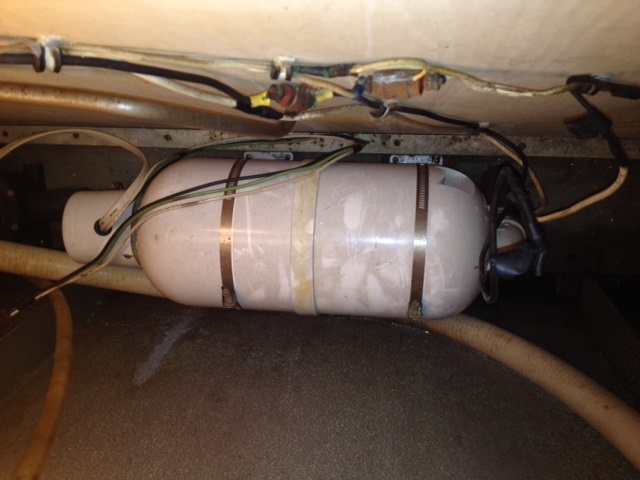

    oval tank on port side before waste tank
    This is the oval tank before the waste tank, the pump is located on the stern end and under the head of the tank, any suggestions anyone????
