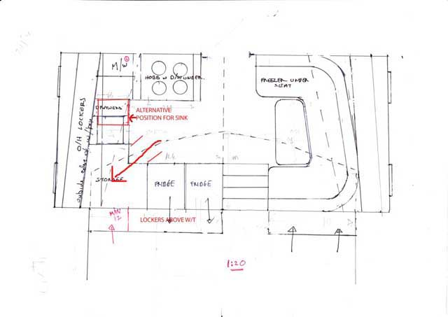

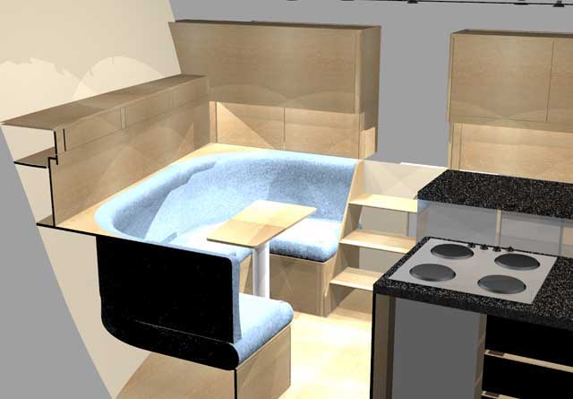

    Vintage Feadship refit - design and build process
    thank you for these kind words - Ive had 5 years and 2 false starts (spain & France) to consider what to do with this refit and it's been quite an evolutionary process to get to where we are now.
    When I was first having her refitted in Mallorca (never again!!), I planned on basically just reproducing what was there already, but the people who worked on her (mainly English Ex pats!!) did such an appalling job that when the boat finally arrived in England I decided to start again and go back to basics. I had pretty firm ideas about the layout I wanted - for example in the galley. I attach a pic of how the galley was when I found the boat, with a large countertop on both the P & S sides - this was not the original galley but one that was most probably built in the late 1970s when the very ugly pilot house was built. After much thought and consideration, (and measuring loads of other boats at boat-shows) I figured I didn't need such a huge galley and that by reconfiguring the companionway to be off the centerline, I could still have a big enough galley on the port side, whilst leaving enough space on the stbd side for U shaped seating.
    I also had firm ideas about the overall look I wanted throughout the boat (a contemporary but hopefully timeless "retro" feel that was sympathetic to and in keeping with her 1960 origins, using light oak with the grain horizontal and 4mm horizontal shadow gaps across the doors and BHs (which, incidentally, the yard originally hated but in fact it has come out so well that apparently they are now proposing to offer it as an option on the new Oysters they build).

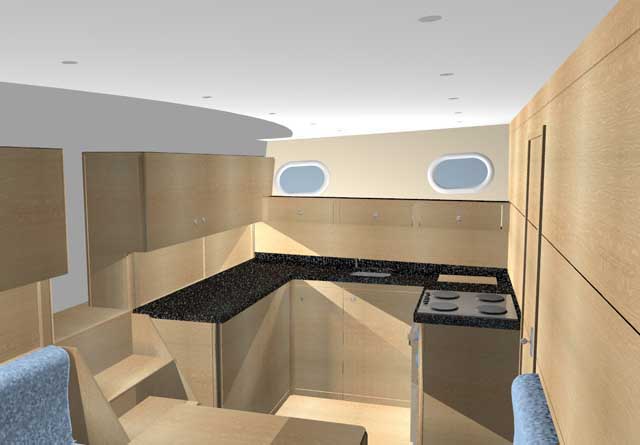

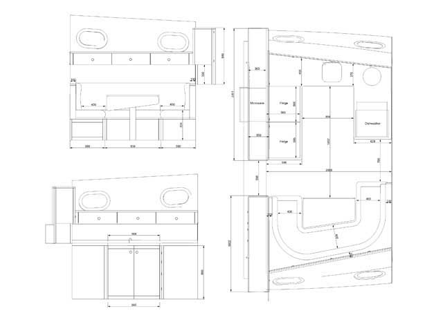

    I attach my original sketch, which the yard converted to CAD, and then used to produce 3D modeling renders. We played with the renders and made a few changes but the design and dimensions are basically exactly as per my original drawing. We then had the parts cut by CNC, which the highly skilled carpenters at landamore put together - although not without the occasional "hiccup" which required some small changes being made - to make a really beautiful and highly practical galley and seating area.
    The same process applied throughout the rest of the boat and over the rest of the week I'll post other drawings and pics showing how the design and build process developed and evolved.

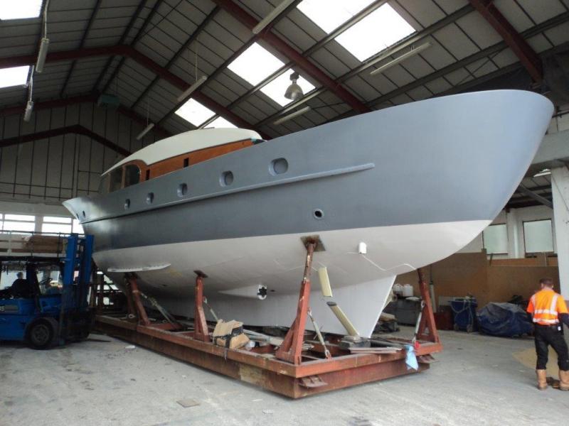

    Feadship TIKY ex Alto Volante
    Hiya
    Tiky (we changed her name back to her original name) is still in the UK, although I'm NE Italy (Venice to be precise) where it is very hot and humid. Work on Tiky was delayed, partly as a result of me getting very sick last year, and partly because of additional issues becoming apparent (mainly shaft alignment /A bracket issues that requires major surgery) but we are at last seeing the light . If we finish before September she may make it south, if not she'll winter in the UK and then do the trip in April. I'll try post some pics of her in the spray shop.

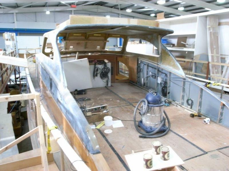

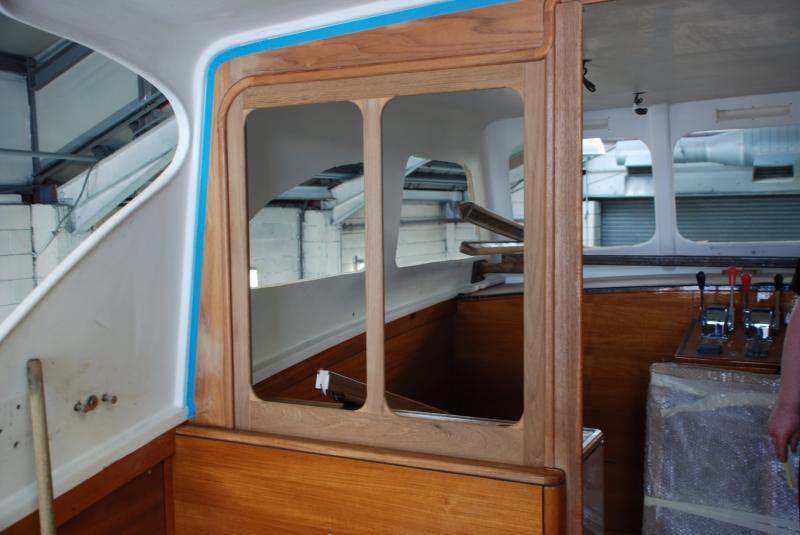

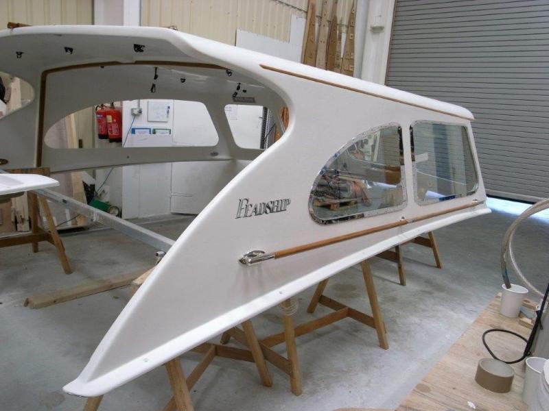

    TIKY ex ALTO VOLANTE.
    Apologies for a very belated reply...we did in fact build the PH in a combination of materials...marine grade plywood for the flat sides, strip plank for the tightly radiused edges, balsa core for the curved roof, and a GRP moulding for the eyebrow. All coated with epoxy and glass scrim. The ringframe arch that forms the frame for the opening aft windows is teak-faced ply and solid teak.

    Tiky feadship Pilothouse
    Some pics of the new Pilothouse . this one without aft ring frame . Handrail has since been shortened .s/s Handrail fittings double as the lifting points for the PH.
    The PH in build

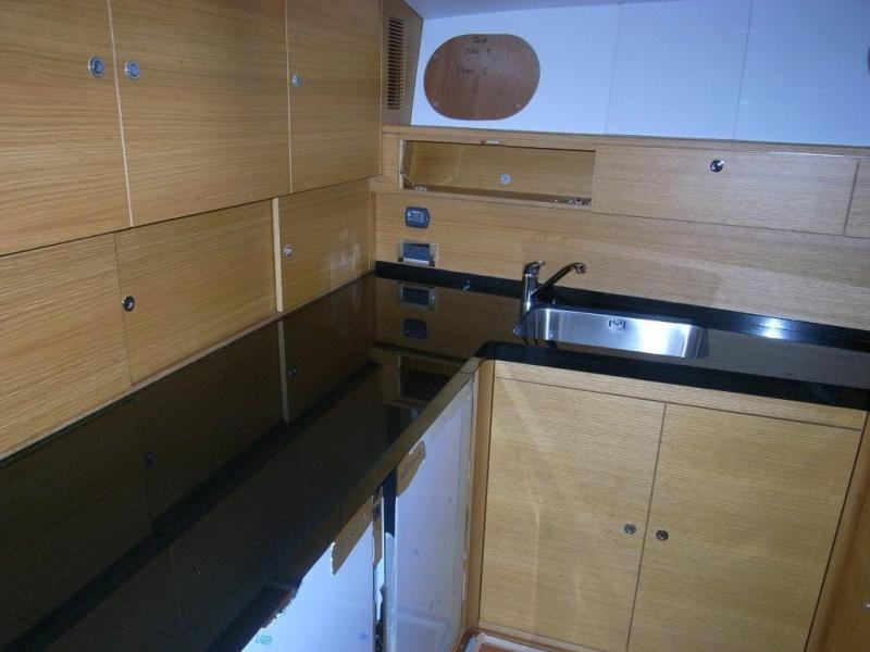

    Some interior shots
