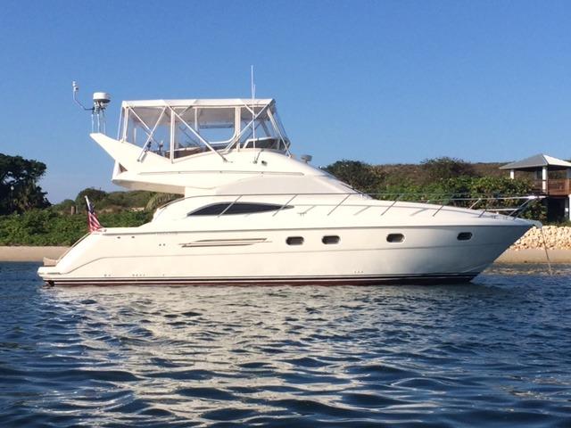

    My 2002 Princess Flybridge 45 was originally sold by Blue Water Yacht Sales.
    They still seem to do a lot of Princess business in Maryland and Virginia.
    I bought the boat in 2016 from Walczak Yacht Brokerage.
    Originally known as Third Daughter, she later became Riverdance.
    She was owner Bill Walczak's personal boat for 3 years.
    His inside knowledge of the brand, would make him
    an excellent choice as your buyer broker for a Princess.
    Despite the endless maintenance that comes with all older boats,
    I have no complaints about the quality, design or performance of my Princess.
    After 16 years, this boat still has the p-zazz of a 5 year old.
