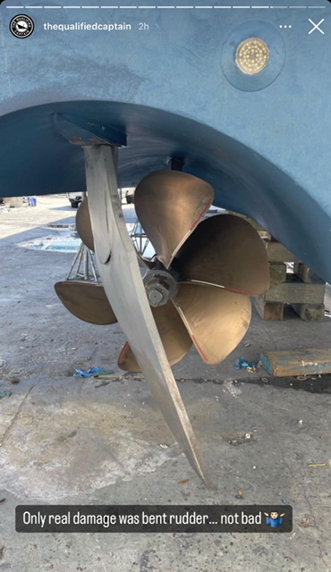

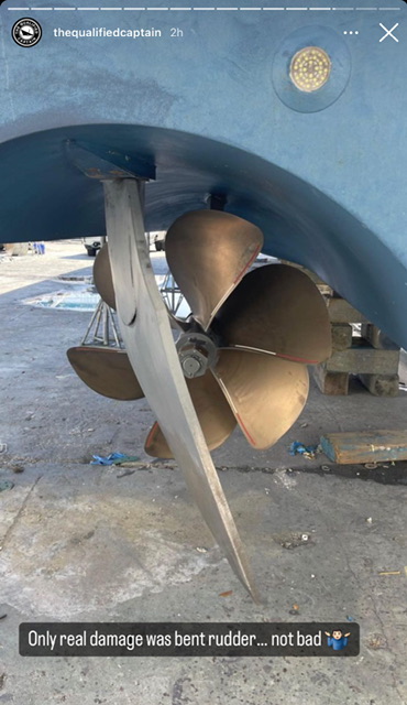

  7. Trinimax
    Trinimax Senior Member
    Jan 18, 2010
    252
    Saw this on qualified captain instragram page. Not too shabby

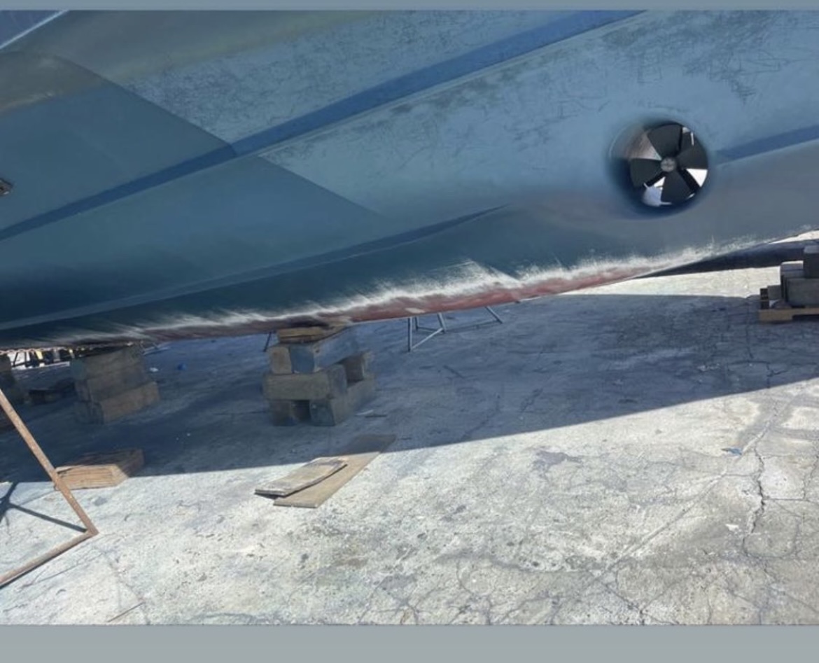

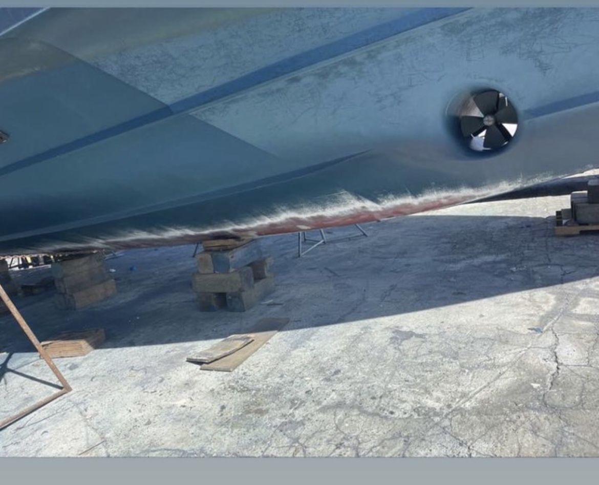

  10. Pascal
    8,945
    Another one from QC. Looks like they got away with it although they may have a surprise when they check the shafts.
  11. Trinimax
    Jan 18, 2010
    252
    I would definitely have a thorough survey done, and will be checking the shafts for straightness and alignment of struts etc. saw someone mention on another forum the possibility of water intrusion into the engines due to the constant waves at the transom exhaust. Hopefully the surge tubes worked as designed.
