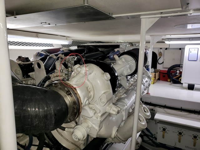

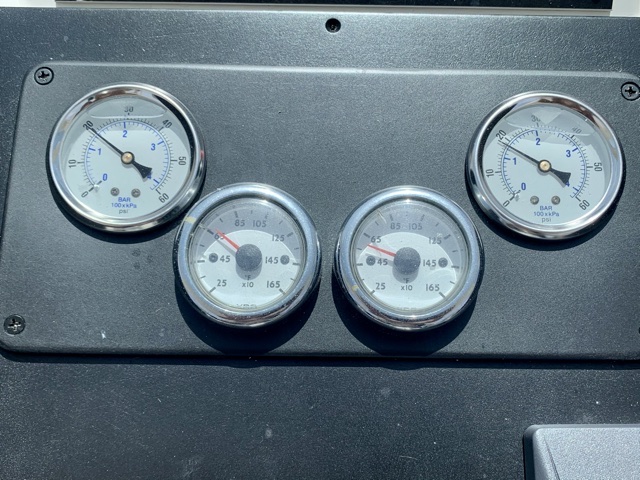

    1996D5C3-85F7-4FFC-91F1-65C14B4F360C.jpeg 21668099-E7A4-4753-8A23-904369DACD58.jpeg
    Here is a picture of my pyrometer sensor (circled in red) and my pyro gauges(2 in the middle) that show my pyro temps. This is at cruise speed of approximately 2000 RPMs. Mapism in another thread recommended that I measure pyro temps from both banks of each engine. It would provide more info. I plan on doing this in the future. So think about that when you do yours.
  14. mapism
    mapism Senior Member
    Aug 9, 2008
    2,116
    Sardinia
    Wow. If you are sure of that, you've got some cool running engines there.
    Though as I recall, in CRM engines the much higher numbers quoted by Capt J are due to the fact that the probe is before, not after the turbo.
    The suggestion of having the pyro on both banks is because it can allow an early diagnose of a faulty injector, in absence of any other reason why the readings shouldn't be consistent between each bank of the same engine.
    PS: just curious, what is the plate under the e/r ceiling in the first pic above meant for?
  15. Capt J
    14,434
    Mapism the plate is polished stainless and acts as a mirror since the motors are so close to the ceiling, you can see down into the motor valley etc if there’s any leaks etc. also acts as a heat shield for the turbos.
    I’d be a little concerned as is because the pyro and boost is much lower on starboard engine in that pic. Are they running at the same rpm?

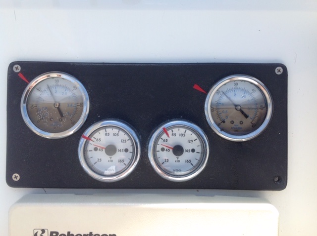

  17. motoryachtlover
    motoryachtlover Senior Member
    Jan 29, 2007
    651
    smithfield, VA
    Here is a picture of the boost and pyro situation right after the turbos were blueprinted. The red marks were what it was before the turbos were blueprinted and the needles indicated what it was after they were blueprinted. I am not sure exactly what conclusions to draw from all of this but thought it might interest some of you.
