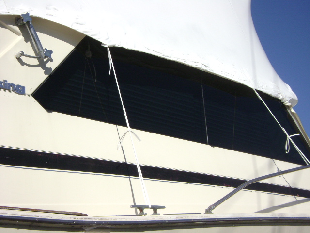

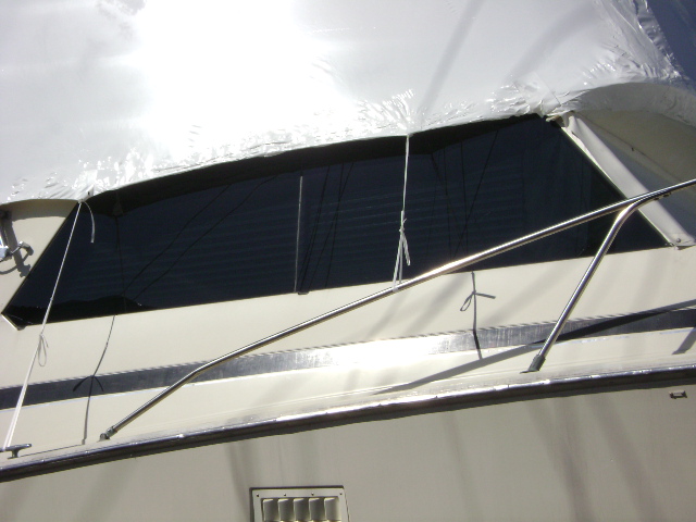

    Yes I removed the side windows on my 35' viking I was tired of the leaks and mold growing in the tracks. Beleive it or not the hard part was getting the old windows out and removing the track work. The most difficult part of the job was removing the bedding compound under the window frame. I hired a "Glass guy" to do the install which I watched and found it to be a pretty simple process. The first thing they did was make a templet of the opening and ordered the glass. once the glass was delivered he installed a 1" X 1" aluminim strip around the opening, then they allpied a very strong double stick tape, set the glass and lastley caulked it in place. I have new gotten so many complements on my boat the install up dated the look of the boat and best of all no more leaks. With the glass to glass seam in the middle and no visable window fram on the outside it makes the boat look like a much newer boat then what it actually is 1977.

    Sounds like the job turned out real well. Do you have any pictures? I would love to see the finished results. Can you send them to: EMAIL ADDRESS REMOVED

  5. Bob B
    Bob B New Member
    Jan 28, 2010
    8
    BayShore LI NY
    see attached pictures

    The new windows look GREAT !

    nice job on the 35 Viking windows,
    I had the same year 35 and always wanted to do what you did to the salon windows.
    very nice job, great boat
