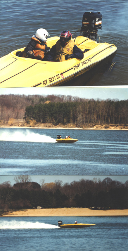

    My racing has been limited to outboard tunnels and Mod-VP, both of which hate a following sea. I've learned not to run them hard in that situation, so have never really had a major stuff except head on with the Allison, which nearly snapped my neck when my helmet flooded and went backwards. With the Sutphen we had, no matter what we ran it in, it never really stuffed. Then again, by that point, I had learned to read the seas and wasn't competing with that boat. The Huckins wouldn't stuff the bow (except when a nuke sub broached ahead of us) but would come to nearly a dead stop at a 15 knot run pushing into a large wave. Not being a professional captain, my experience is limited w/r/t variety of yachts.

    I was running ~80 in the Barnegat Bay (off Bayville NJ) in 3' seas with a very short period. No good reason for even staying in the water with this boat... 1st all-Kevlar boat built by Allison, weighs just under 1k# with me and 10 gallons of fuel, with 370HP of Dick O'Dea prepped Bridgeport on the transom.
    Probably should be in another thread... but, I never would really air it out with anyone else aboard. Chine walk is a bad thing when other people aren't prepared.
    I know I was lucky but I still feel it nearly every day.
