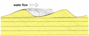

    I was wondering if anyone can tell if the boat is facing in the direction of the prevailing current by the lines in the sand around the boat? Just curious
  13. NYCAP123
    11,209
    Would you expect the current effect to leave this boat stern to, broadside or bow to the current given it's shape, appendages and damages?

    Looks like the current is either coming from the starboard or port.
