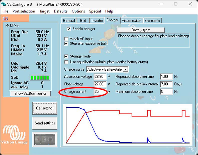

    I just checked how I configured the max DC charge I previously mentioned.
    And I did that with a program that is possibly the less user-friendly of all Victron tools, which in fact according to their recommendation is only meant for trained personnel. Which I'm not - but both myself and the unit are still alive, so obviously it's not really rocket science... :)
    Anyhow, to follow up also on @MBevins question, this so-called "VEconfigure" software gives the highest degree of customization, and the screenshot I'm attaching below, which is just one of its several "pages", gives you an idea of that.
    But in most cases, you don't need to ever use this tool.
    Back to the point, if you wish to limit the DC charge current regardless of how much AC is available (and/or limited by the knob on the DMC panel), this is the configuration screen allowing you to do exactly that, among several other parameters. As I previously mentioned, my unit is rated for a max bulk DC charge of 70A, but I chose to use only half of that, as per the parameter that I highlighted in a red circle.
