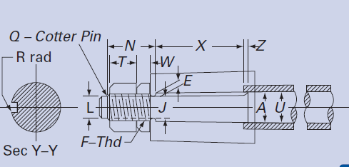

  5. PacBlue
    PacBlue Senior Member
    Jan 9, 2009
    2,002
    Dana Point, Ca
    Yards usually use the large Heavy Nut to crank on the prop and make sure it has seated as far forward as possible. But then they get lazy and do not remove the large Heavy Nut to put the Jam Nut in its proper location:
    The good news is that you will get a warning if things have gone wrong, by a noticeable vibration, mainly after you have grounded or hit an object. The thinner Jam Nut can only hold so much against the larger Heavy Nut, its just comes down to physics.

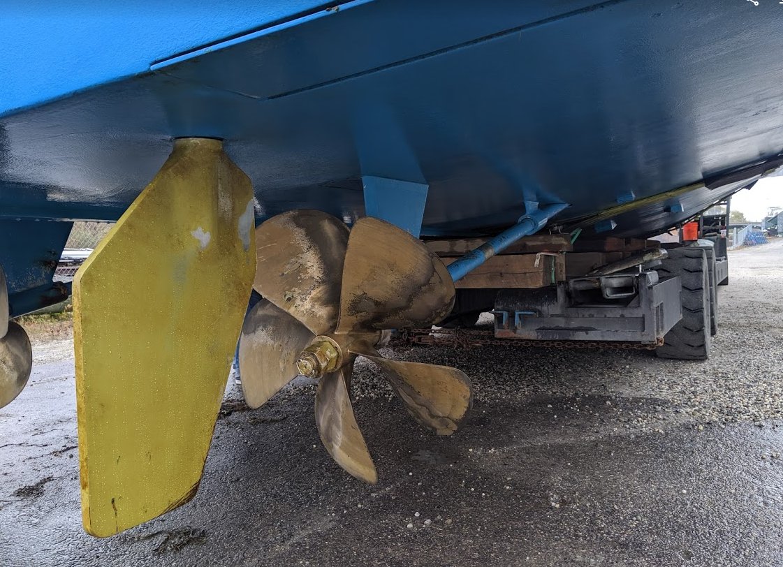

  9. Fixinbones
    Fixinbones Member
    Jun 10, 2012
    69
    Easthampton, NY
    Nah, I meant to say that the surveyor mentioned the nuts being wrong but at the Viking Service Center when they changed the props they said that Princess installs them this way on all of their yachts
  10. Fixinbones
    Fixinbones Member
    Jun 10, 2012
    69
    Easthampton, NY
    So question for you knowledgeable captains. If the prop was repaired, how long does a repair usually last. The boat was traded in April with a clean survey and then a clean survey when I purchased it this month. Is the repair likely a few years old?
  11. Capt Ralph
    14,578
    Whoa!!! That is a very hard question to answer.
    IMO (due arguments); a proper repair on a proper repairable wheel should last forever. This does NOT include the original mfg's performance design or fine tuning.
    Example; Every prop shop has a set of cast iron blocks to shape Michigan wheels. It's rare to find a shop (if any) shops with Veem blocks. Also in shaping and grinding, I've never witnessed a Veem prop to come back with the trim line re-usable. A rebuilt prop always looses some of the mfg's fine efforts.
    The wheels that come back will work. The boat will go forward, not grind your teeth and make close rpm.
    Over all, your wheels should have not busted up like they did. The repair shop had the opportunity to condemn the wheels and not repair them if they were in that bad of shape. Lack of bacon on their plates may have driven them to try the repair.
    OTOH, if the owner begged the prop shop to just make them work,,,,,,, Bacon on the plate still.
    Then bacon grease on the sellers face. I'd rather have a honest shop than a hungry one.
    Don't go to that prop shop.
  12. Capt J
    14,898
    Actually you need to install the nuts that way with that system. If you look in the second photo, the washer between the nut and the prop is a lock washer and is designed to be bent over onto the first nut to lock it in place. Once bent over the washer tabs will be too deep, or over the thin nut and you won't be able to tighten the second nut. Usually I don't see this system with a 2 nut system, usually just the washer and a single nut on Princesses.
  13. wdrzal
    wdrzal Senior Member
    Feb 6, 2006
    415
    Tin tabbed Lock washers only lock if half the tabs are bent forward and half backwards , so each nut is engaged.
  14. Capt Ralph
    14,578
    Post #16, second picture does not show a tab washer. Those are threaded holes for a removal / install tool (Prop Smith?).
    Also in the pic from #26, threaded holes.
  15. Capt J
    14,898
    The ones I recently saw on a 2015 Princess, had a cutout where the lockwasher rode over the key way and was locked into place by the keyway and then the tabs bent back.
    That being said, I have never personally seen an issue from the large nut installed first, versus the proper way of installing the small nut.
  16. Capt Ralph
    14,578
    I agree. See #24 above.
    I recall the kids at Huckins Yacht puts their new builds together with small nut first.
    Any customers prop they service on the hill, it goes together as it came apart.
    Our divers did the same, together as it came apart.
