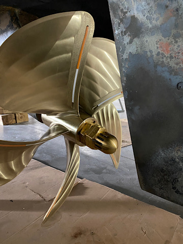

    We replaced the Michigan 4 blade propellers on our 42 Open this week with Veem Interceptor 5 blades. There is noticeably less vibration when running and we picked up .8-1kt at cruise. However with 3/4 fuel, full water and the tender, the boat was making 2315 rpms at WOT when the engines are rated at 2350, so we're a little over propped. They're working on getting me the different Interceptor Strips which should fix the problem. On Veem's site, it says they can be changed in the water. Does anyone here have experience or suggestions with having a diver do it vs a short haul of the boat? My mechanic is willing to dive, however if its considerably easier to do on the hard then I'll go that route.
    Appreciate the suggestions..

    They go out/in just like gaskets in a window frame. You will need some visibility. One of our divers has experience doing them but even then, prefers the boat in the slings for 30 minutes.
    In your future, ensure a Veem shop works on them to preserve the notch. In horror, I have witnessed other shops just grind the strips away and return a non-trim-able wheel.

    On new props it would be pretty easy to change them in the water. They slide out toward the root. The only complicating factor is that you have two strips on each blade, but I expect you’ll put all white ones back in, so reinstall is easy.
    After the props have been in service and you start to get some marine growth in the slots it becomes harder to slide the strips. It once took me an hour on a workbench to replace 10 strips.
    Another option is to shave down the orange strips with a razor knife.
