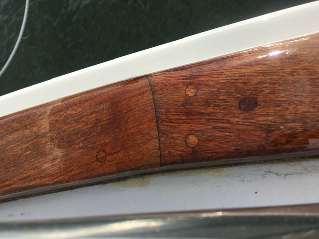

    It's possible. But the haul out and the 100 yard ride on the lift to where they blocked me could have started the fine crack process at the joint as you pointed out.

    Sorry to say I could not bring myself to cut into my toe rails due to the following; the joints were all nice and tight/clean with no gaps and no evidence of movement; second I only have and electric saw zaw to cut with and would have to cut from the deck of the boat, I have no dock to stand on to get at it properly. I had the saw in my hand, but I aborted the ''mission'' knowing I would really mess things up.
    Third, my boat time is hard to come buy and it was just easier to scrape the lifting varnish back a few inches on both sides of the joint , sand the varnish down flush with the wood and double coat the raw wood to the existing varnish on two weekends. I got six build up coats on , then sanded the area down smooth to blend in with the existing varnish then put on two coats over the entire toe rails. Looks real good, you can not tell where it was blended in. Color is consistent through out.
    I still agree and like most of the ideas offered to me. And perhaps with the right saw , dock and time, I will cut, epoxy seal, and fill in with sikaflex.
  4. cleanslate
    cleanslate Senior Member
    May 29, 2018
    1,661
    Cherry Hill, NJ
    Here is the build up coats, finish two coats went on next.

    Smart move. Nothing wrong with that joint. (Maybe I'd have cleaned it out a little with a very fine file.) IF the joint was spread and gunked you would have cut it with a fine hand saw like you use to cope moldings with. A Sawzall would have led to a disaster. Save that for cutting 2 x 4's, tree limbs and pipes. Good job.

  8. Capt J
    14,892
    Nice job, but your joint is too tight and it will happen again......

  11. Capt J
    14,892
    The black in the joint is moisture. You can also see a moisture drip line from the bottom right teak plug. The joint is simply too tight. You can even see slight bulging at the joint on the top and bottom of it in the photo. The varnish didn't lift at the joint for no reason.
  12. Beau
    Beau Senior Member
    Jan 15, 2010
    2,261
    Beaufort, NC
    Agree on the moisture probability, but not the fit. Good eyes on that bulging. I would have chalked that up to edge sanding if I had even noticed it. So what's a good solution to dry it out before he applies another 6 coats? Short of a narrow saw blade?
  13. T.T.
    T.T. Senior Member
    Jan 22, 2010
    92
    S.F.
    Capt. J has a good eye and his conclusion comes with experience. Tight joint + flexing boat + expansion and contraction is too much. The varnish will not bridge the joint and moisture finds its way in much easier than it can evaporate out. Once the moisture gets in, it to will warm up, lifting more varnish.
  14. Capt J
    14,892
    A narrow saw blade or dremel to open up the joint then fill with that putty made for teak joints then varnish.......is the only answer.

  17. NYCAP123
    11,209
    I'm of a different opinion, although I agree the joint should have been cleaned out as I mentioned in #46. (Yes Beau a jewelers blade or file would probably be ideal for the job.) Moist wood can only shrink. That means that opening the joint further will lead to a gap as it dries. Whether to open a joint further or leave it as is and just clean it depends on the humidity where the job is done. In NJ I'd leave it as Cleanslate did. Where J is I'd probably agree with him depending on humidity at the time the job was done. You can always cut wood away. Once gone you can't put it back.
  18. d_meister
    d_meister Senior Member
    Mar 4, 2010
    513
    La Conner, WA.
    Moisture wicks up from underneath. I would reef out as much bedding from under the wood as possible and then inject bedding in under it. Boat Life makes a thinned caulk that will be easier to force into the space. You could use West System syringes to better apply the sealant. A hack saw blade could work well for reefing the old bedding out.
    The problem with the joint in the picture is that it is close enough that any movement will "shear" whatever sealant/adhesive is in there. It does look as it's well secured, though. so the varnish should seal the top and sides from the outside.
  19. Beau
    Beau Senior Member
    Jan 15, 2010
    2,261
    Beaufort, NC
    What about that dark middle bung, does that indicate a broader water intrusion and that new bedding may be in order as discussed above. I can't imagine that's just a carpenter's mismatch
