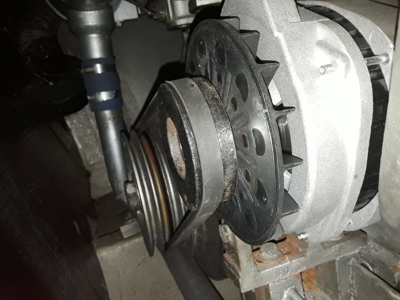

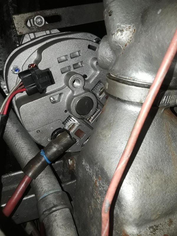

  8. Capt Fred
    Capt Fred Senior Member
    Jun 22, 2009
    319
    Long Beach CA
    CR, as requested a few pictures of the CS144 installation.
  9. Capt Ralph
    14,581
    Mighty Fine.
