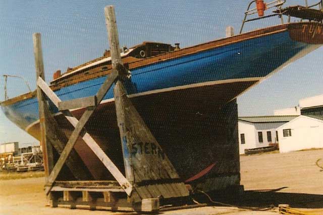

    I have a Abeking & Rasmussen sloop built in 1935 by Henry Rasmussen and was used by German Navy during second world war. It was taken as a prize of war by Britian and presented to Canadian Navy who used it for races and eventually was sold thru war assets. How would I find out which particular boat it was as it had no hull number as it was built before they put them on the hull.

    I have pictures but I'm having trouble attaching them. How do I attach? Overall length is 12.45 meters and from the fore part of the stem to the rudder stock is 34 feet and 2/10

    At 12.45 m she is shorter than Naldera at 12.60 m. To post a picture you should preferable have a JPG less than 640 pixels wide and follow the instructions in the "Manage Attachments" window which appears below the text field.

    Thanks for your help - pictures are attached

    To me she look very much the same as Naldera. Why do you think she was named Amsel if it isn´t the original Amsel?

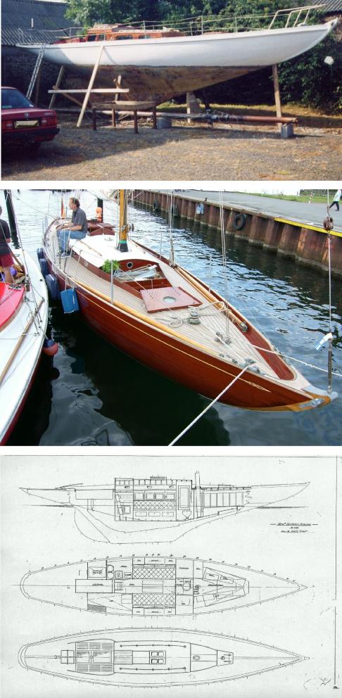

    I'm restoring an 50m2, build 1937 at A&R, Build Nr. 3232 and I can say from the one picture with the blue Hull, this is a 50m2 for sure.
    The form of the bow above the waterline, the stern overhang and the deckhouse make an identification easy to me.

    The varnished boat was restored to original condition in 2007
    the white boat is mine, stored in the garden of the previous owner in brittany, france and the plans is the version with the short deckhouse, usually build for the navy or airforce.
