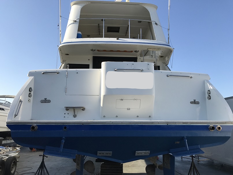

    Ok you guys are making it difficult, now I am leaning towards getting lights again! My biggest concern now is the beam angle. Does anyone here have a reverse or angled transom below the water line? As you can see in the attached picture, the mounting area for my lights would be angled downward roughly 30-40deg. Has anyone installed lights on an angle like this and do the lights have a wide enough beam angle that the light still shines aft fairly strongly versus just downward? Pics would be great if you have them![​IMG]

  6. Pascal
    8,946
    I had this on a 70 johnson years ago. The yard did a mounting block out of fiberglass. Easy to do with Coosa as well
  7. Capt J
    14,896
    That's easy, they just put an angled spacer in between the light and the hull. That's easy peasy.

    Sorry to hijack but what kind of boat is that? Can't say I've ever seen a (is it considered transom or bottom) like that. That said, although angling the lights should be no problem would putting them on the perpendicular area just below the water line work? I might be concerned with the amount of force water flowing past the lights might exert in that lower area.

    Its an older Mikelson (link) . And it is the only one I have seen with an enclosed flybridge so makes it look a bit different.
  11. Pascal
    8,946
    Easy to make. Take some 2” coosa, epoxy two pieces and cut at an angle matching the transom. Epoxy on the transom. Install the lights.

  12. Capt J
    14,896
    Exactly. Any boat yard can make them.......they're pretty easy to make.

    Thank you. Interesting deign. Nice. DK that I've run across one before. J or Pascal what would you think about mounting them on the perpendicular section just below the surface. My thought is that on the slanted section you'd put the lights on blocks, which is easy, but they're going to disturb the water flow. That looks like a very detailed slanted section. Might create vibration.
  14. Capt J
    14,896
    Just put them on angled blocks so they're level. At anything above idle speed, they'll be out of the water so won't effect anything.

    I can think of a couple of boats that I've seen with a similar transom.
    Both from small Italian builders, whose name is irrelevant, but I can see why you find that unusual, anyway.
    In the cases I'm aware of, it was a sort of builder's afterthought, driven by the market demand for extended swim platforms.
    Which is more easily addressed by making an additional mould for it, and then bolt it to an existing hull transom (fairing the joint with filler and gelcoat), adding also a bit of static stern buoyancy in the process.
    Maybe that's what also Mikelson did, 'dunno.
    Back to SoCalD question, I wouldn't bother doing anything at all, because the u/w light effect can be even nicer, when they are angled downward.
    So much so, that I've seen downward angled blocks made as Pascal suggested, but for the opposite reason, i.e. to point downward the lights installed on a more "normal", almost vertical hull stern.

    Only time I remember seeing similar bottom design was on the old oar-driven life-saving surf boats and whaling boats. The V-shaped ridge (not from those old designs) looks like it's designed to break up the water flow in a very specific way as it goes across a plate to reduce drag as the water leaves behind the boat breaking suction. That's why I think putting a few wedges there for lights could be a really big mistake.
