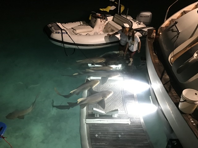

  20. Pascal
    8,716
    Installing underwater lights... $2000
    Petting a row of nurse sharks lined up on your swim platform.. priceless.
