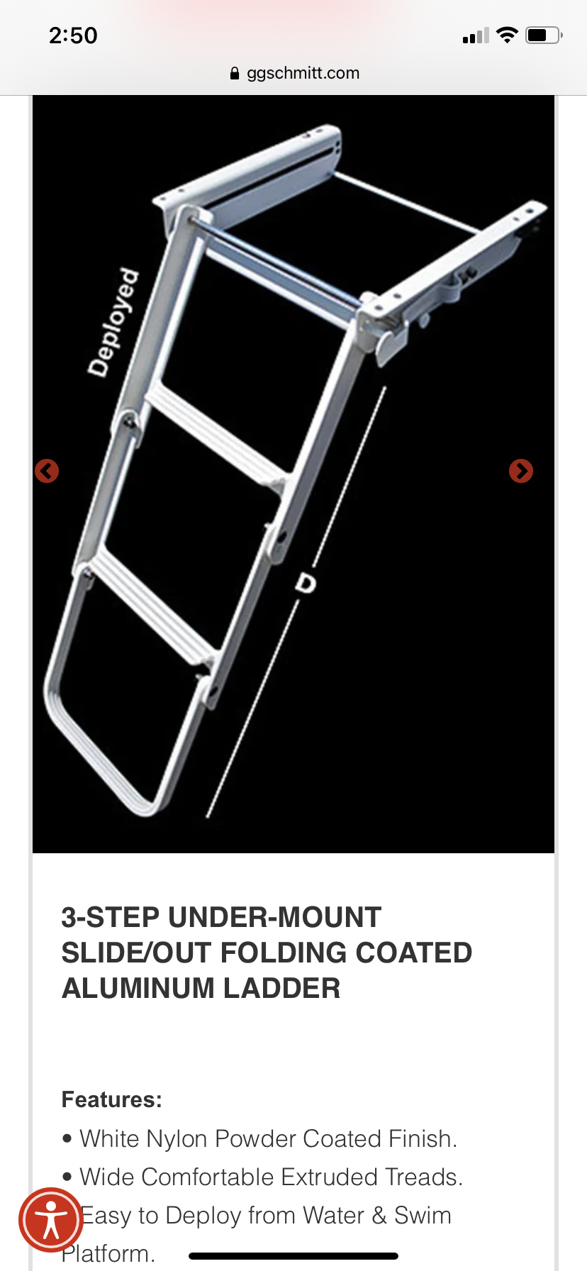

    I have this ladder by ggschmidt in Florida. Has held up well. They have stainless steel ladders with same configuration too.
    Having trouble uploading a picture. Mine is powder coated aluminum.

    This looks interesting and way cheaper than I expected. Does it lock when in the vertical, deployed position so it doesn’t just swing under the boat when you try to climb aboard? I didn’t see mention of that in the description. Is it a good positive locking design when stowed to prevent accidental deployment while underway? Thanks!
  8. Capt Ralph
    14,492
    Locked in vertical?? Not what you want.
    Locked while secured? Others use a velcro or bungee strap to keep it in storage mode.
    I felt this to be a poor design and did not go here until I found this locking in place ladder.
    It takes a bit to get use to it but has never come loose as many other designs do, while operating.
    I can offer a picture this weekend. I was considering a on platform hand hold but nixed another toe smasher. Mounted rite in front of my transom ladder as you crawl up, grab the platform vent and/or transom ladder.

    Why would I not want it to lock when it is in the deployed or down position? I don’t want something that is just going to swing under the boat when someone tries to climb the ladder.
  10. Capt Ralph
    14,492
    There is a hinge stop that keeps the ladder from going under the deck. This stop will hold our weight. Ladder angle approx 160°.
    For a whole rigid ladder? Every lil wave will try to rip it off of your platform. The hinged attachment point allows it to fly aft.
    When you board the swim steps, your weight holds it mostly vertical pending the next wave.
    Your not in a swim pool behind da house but live action sea water. Anything less than a space capsule recovery device (say 50K pounds?) has to flow with the water or rip the platform apart, or at least deform till the machine screws pop off.
    Oh, despite the ad pictures, you are going to thru bolt this gizmo into place with big asp truss heads and nylock nuts over heavy/wide washers.
    Pending your deck core material (wood?), possible epoxy sealing the thru bolt hole.

    I get your point. I chose my words poorly when I said lock in place. Hinge stops as you indicated is what I’m after. Thanks for the input.

    I have installed several undermount ladders from Schmidt, very well designed and made.
