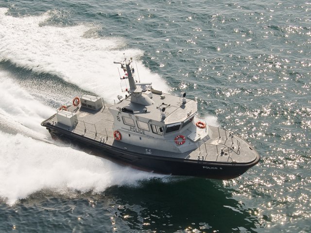

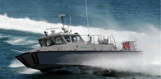

    Dear all,
    I'm working in a shipyard in Taiwan.
    Our shipyard is skilled in aluminum patrol/rescue boat building.
    The following boats are all designed and built by our own.
    Recently, my boss has an idea to develop some new products.
    One of the ideas is to try to build an aluminum sportfishing yacht.
    His idea model is :
    length over all is about 40ft,
    aluminum hull,
    express type with tower sportfishing yacht.
    In all honesty,
    our engineers are professional in ultra fast boat design,
    but not in yacht design.
    We don't know the concepts, systems and hardwares of a sportfishing yacht well.
    Therefore, we think taht we need some outside helps to develop the prototype.
    Could someone introduce us any design company good at sportfishing yacht design?
    Or if there is someone familiar with the operating of a sportfishing yacht might be interested in this project?
    Thanks!

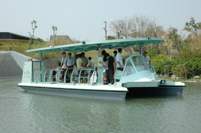

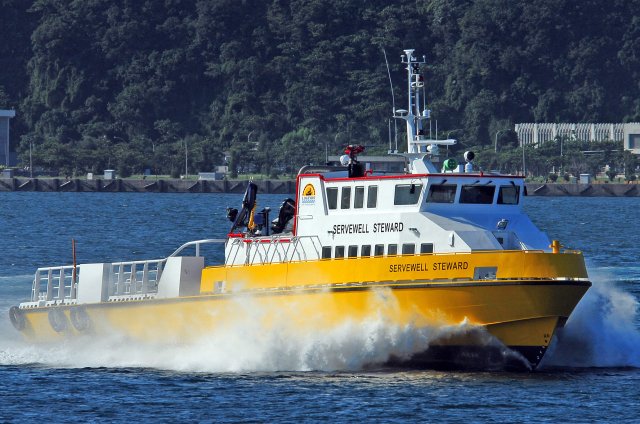

  7. JeffSheu
    JeffSheu Member
    Apr 30, 2007
    49
    Taiwan
    Thanks for your suggestion!

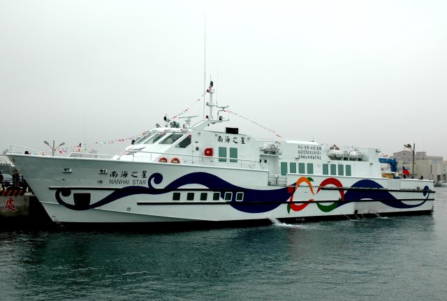

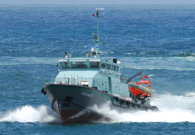

    We now have the above products indeed.
    Our company built aluminum solar water taxi, ferries and crewboat.
    Here comes the photos.
    My boss wants to try something different from before.
    Sportfishing yacht is one of his ideas.

  8. NYCAP123
    11,209
    You guys build some nice looking boats. Especially like that tour boat; very unusual. If he really wants to go SF might I suggest you go high end, especially since you'll be going Aluminum. It's really a bad time to enter the small yacht market with companies closing and cutting back all over.

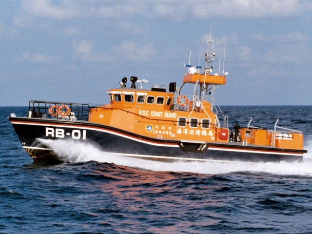

  15. CaptainSilva
    CaptainSilva Senior Member
    Dec 9, 2006
    159
    Newport, RI
    Looks to me like you have the start of a nice hull to work with on that RB-01 Coast Guard boat. The bow has a nice flair to it.
  16. JeffSheu
    JeffSheu Member
    Apr 30, 2007
    49
    Taiwan

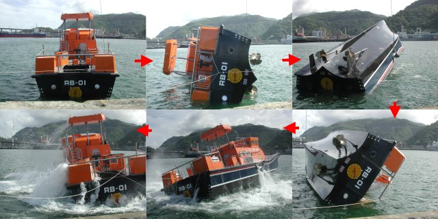

    RB-01 is a self-righting rescue boat for Coast Guard.
    We delivered three from 2001 to 2002.

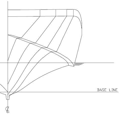

    The sections of the bow is as the attached picture.
    Is the flair also good for Sportfishing yacht?
      59 KB
      3,065
      21.8 KB
      2,165

    Apologies for the long post above. I was looking at the photos of the boats JeffSheu posted, especially the Customs 2 boat and RB-01, as well as Jeff's last post on this thread, and found myself looking at the prominent spray deflectors that can be seen doing their job on both boats. I've seen similar examples on other boats but seldom from US builders, which seem to use smaller spray rails and place them lower down, and I wonder why this is.
    Jeff: how long are the hulls in your original post?
