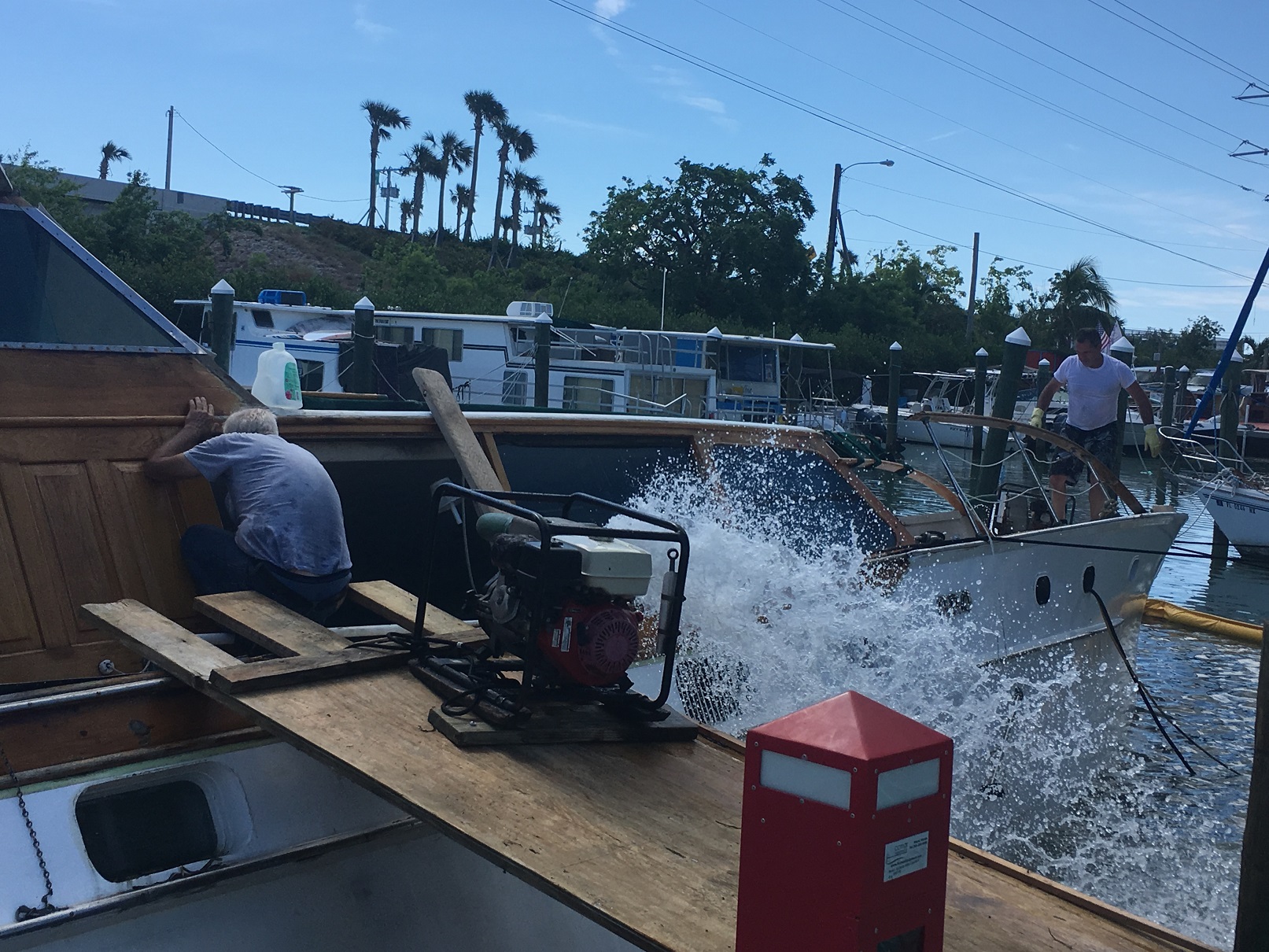

    I am sad to report she is probably done. We are but stewards of these beautiful craft, if we cannot adequately maintain them we should pass them to someone who can before they end up like this.

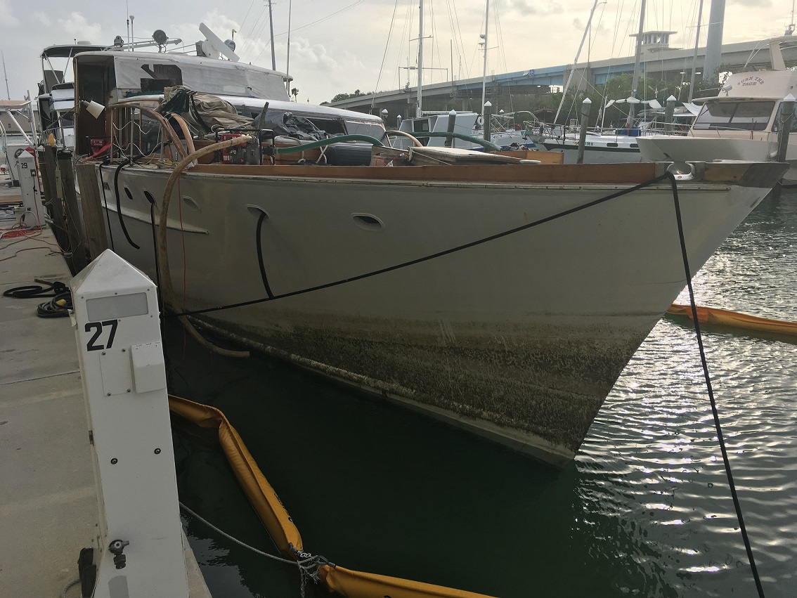

    A gentleman who owns a Trumpy and loves them financed an expedition to Islamorada with myself and another to raise her, hoping to take over and restore her. We did raise her. I am saddened to report she was in horrible condition before the storm with rot everywhere including the teak and in addition was found to have a worm ridden hull. The only way to adequately control the flooding was to cover the hull with plastic. Reports from others at the marina indicated she was living on a 110v pump well before the storm with her bilge pumps cycling when it couldn't keep up. The storm damage was minimal. Irma did not sink Tireless, she was murdered by neglect. We left her floating. Reportedly she will be towed to a waterfront bar where she will serve as overnight accommodations until she finally falls apart. This is beyond sad, it is in my opinion criminal.

    I'll be posting some more pictures as I have a chance to resize them. I must say, the sponsor of this venture really wanted it. At one point he worked, by my accounting, 32 hours straight.

    Not much more I can add to Baltimore Bob's first post. This truly was a sad four days. We gave it our best shot. Thanks for your efforts Bob and Steve. Though we try we can't save them all.

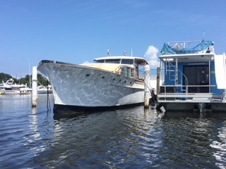

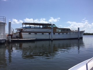

    But your answer is inaccurate and uniformed. They may have poured their heart and soul into "keeping Tireless afloat" but definitely not doing what was really needed. She was kept afloat with a 12v pump running constantly and the bilge cycling on and off to help out. They didn't do the maintenance that a boat like this requires for many, many years. The decay in all areas of this boat didn't happen since Irma, didn't happen over the past year, didn't happen over the past four or five years.
    Baltimore Bob, myself and a third gentlemen spent four intimate days on this boat trying to save her. If Tireless was a woman she would feel violated I was poking around and looking at so many intimate areas of this girl. I personally was in the water for hours over three days inspecting and filling holes and stuffing things in the holes. I was in the crew cabin and galley while she was still on the bottom, I was in the engine compartment trying to patch holes in the exhaust system trying to stop the water from coming in. My eyes saw the marine tex patch on the manifold. I was in the lazzarette watching the water streaming in like someone had turned on a garden hose. It was my foot that went trough the starboard deck at the front of the house. The softball sized hole that was covered in duct tape that was UV rotted. I stuffed the nerf ball in the hole so the water we were trying to pump out didn't run right back in.
