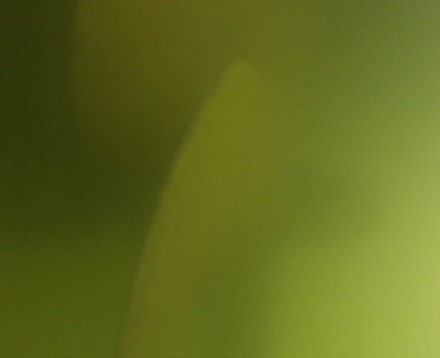

    When I feel lazy and don’t want to get in the water I mount a GoPro on boat hook and dunk it while recording video. It will show things wrap up

    I actually tried that, but the waters in my marina are too murky to see much of anything...
