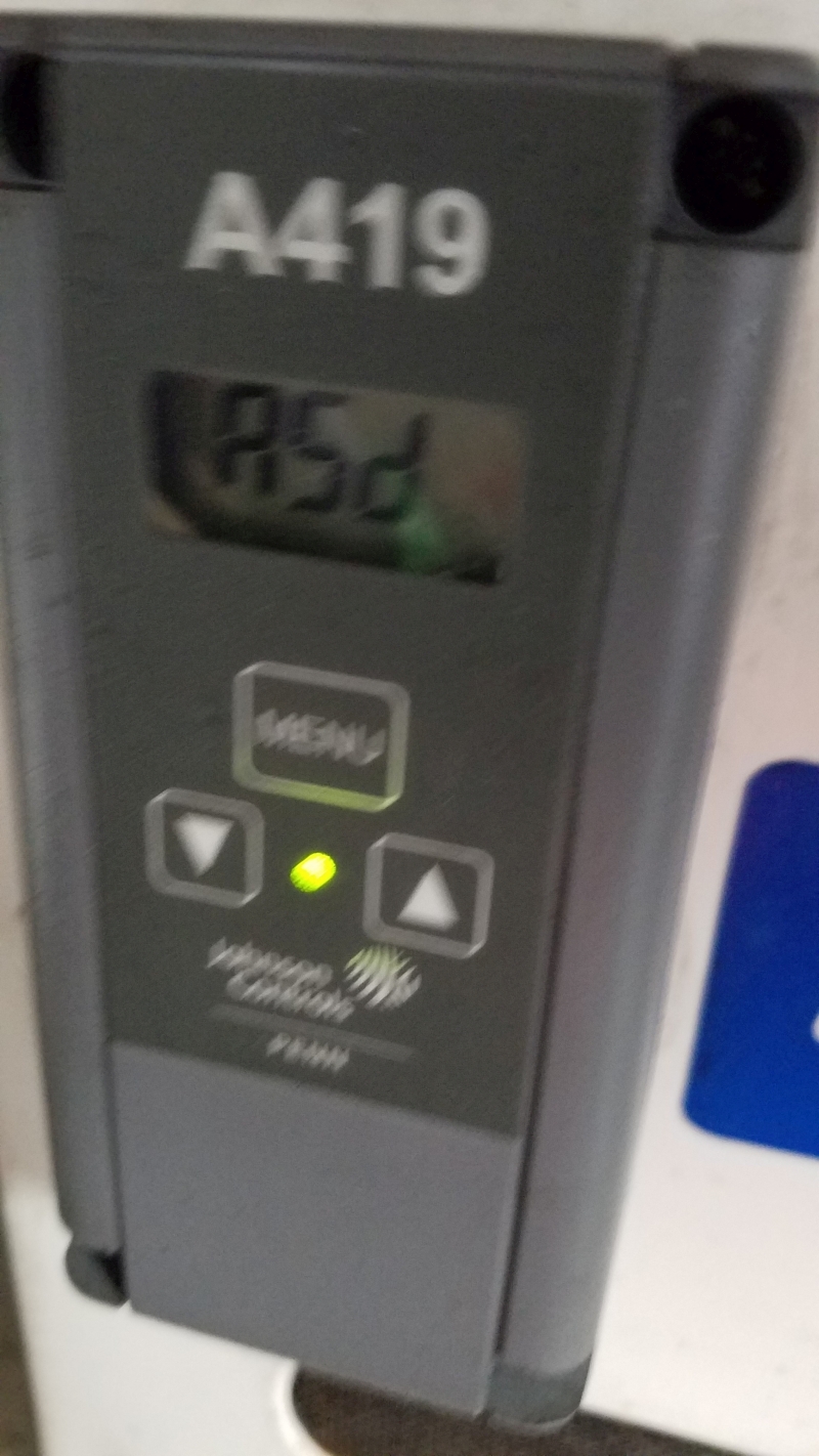

    Just putting these on for the heck of it. First is the display on the unit. This code alternated with the freezer temp for about 30 seconds until the fan kicked on. Not sure if that means anything or not.

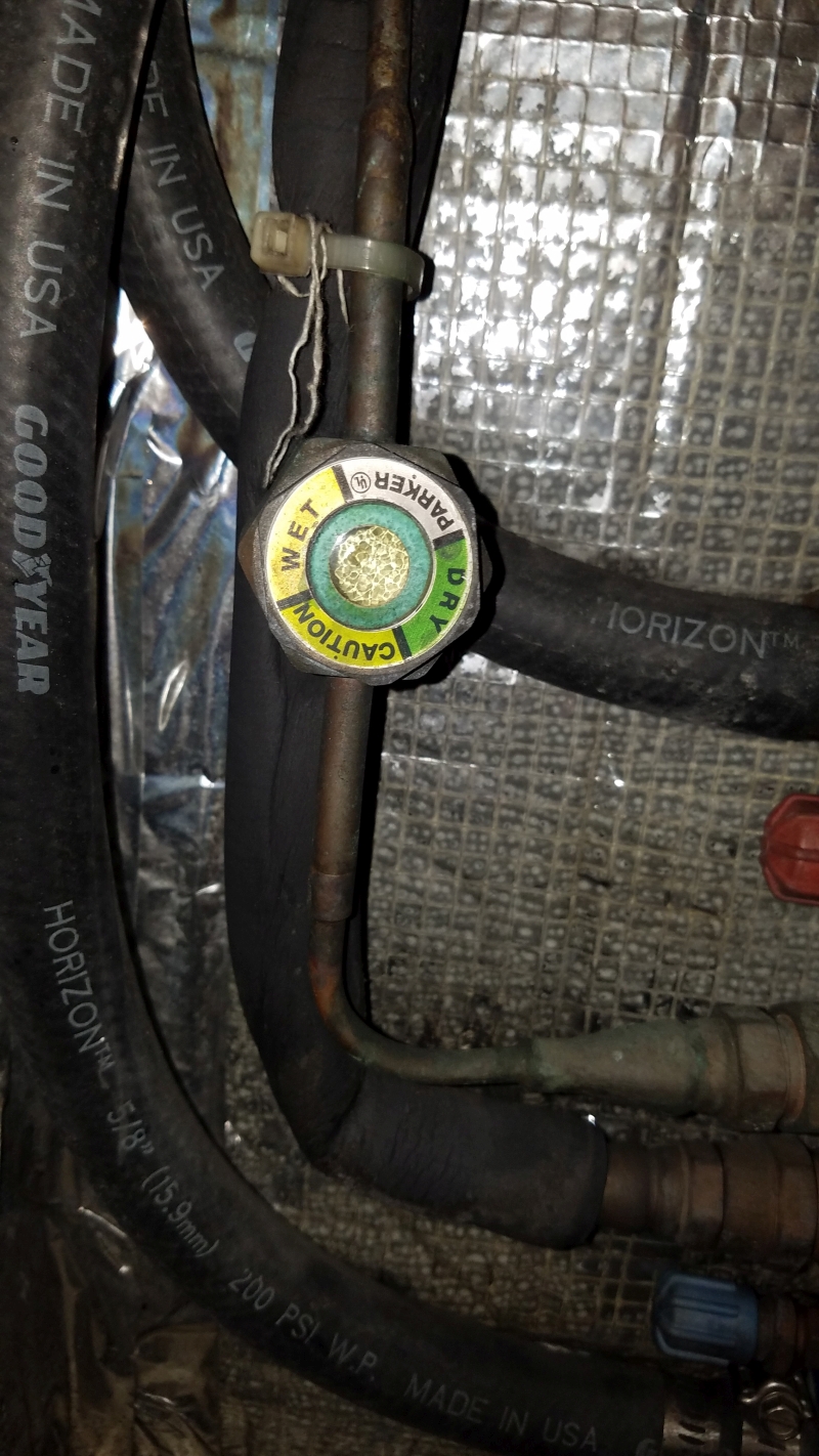

    Second is a pic of the site glass. I didn't see any bubble when I turned it on, no visible change in site glass. Not sure what that means.
    There is a sticker on the unit that says it contains leak detection die and leaks can be found with a UV light. Don't have one handy but may try to get one if I beat the AC tech to the boat. Probably a moot point as I'll need him to make any repair or recharge but just curious. display.jpg stie glass 2.jpg display.jpg stie glass 2.jpg

    Looks more like a moisture indicator than a sight glass.
  10. Capt J
    14,435
    I don't know anything about your system. BUT, I can say with 99% certainty that under neath that blue and red cap in the picture are your high side and low side freon charging ports seen in the picture with the moisture gauge.

    Almost all sight glasses double as a visible moister meter. They put a piece of hydroscopic paper inside that turns a different color when moisture is present. Oil circulates with the refrigerant , look for signs of oil on the tubing at all connections, whether brazed or flared. If you find a oily tube you found your leak. In your picture the joint above the sight doesn't look dry but oily plus the braze job looks terrible.

    I just want to say thanks for the good natured help. Not the case on some other sights. Pretty clear this will be beyond my my ability to fix so I'll patiently wait for the tech. But I'll talk to him about that suspect joint. Will let you all know the result for future reference.
