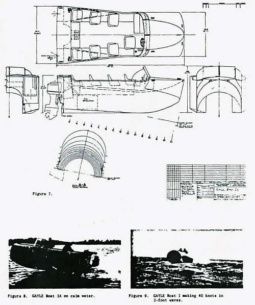

    In this paper I saw mention of the FICATs (Favorable Interference CATamaran), and the Gayle boats
    http://www.dtic.mil/dtic/tr/fulltext/u2/a081325.pdf

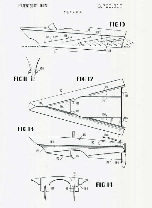

    ...and in his patent paper I saw a quite different version (sort of a tri-hull configuration) of his idea that had no specific name if I recall.....below

    ....the Gayle boats...another 'multihull' theme
