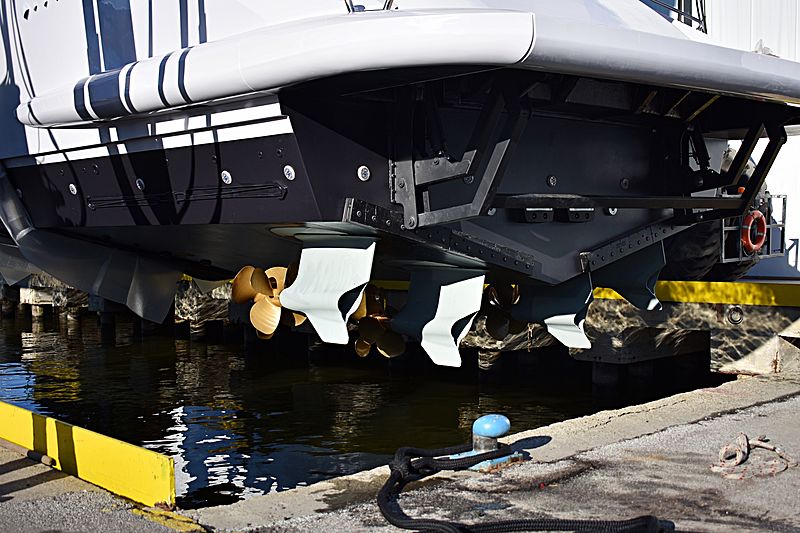

    I just noticed in this photo of the latest 100 footer launched by Permare that they installed interceptors rather than trim tabs from the factory, and this thread popped to my mind.
    Wondering if anyone had a chance to make any further experiences/comparizons, in the meantime?

    8,149
    Interesting. Lazzara eliminated trim tabs on some of their boats including the 84 i run. Instead there is a 1/4” strip of SS at the edge of the transom where tabs would be. Pretty much a fixed Interceptor. Works very well as the boat pops on plane with almost no bow rise at 1500 rpm and 15.5 kts. Doesn’t seem to create a lot of drag even at high speed. 1950 fast cruise is 26kts...

    I think traditional tabs provide more stern lift on the slower boats that need help (more stern surface area) to stay on plane. On faster boats that solidly stay on plane without the use of tabs, and the tabs just add more speed and better running attitude, the interceptors help and they do a good job at stabilizing the boat. Traditional tabs seem to do a better job at correcting list, on boats that routinely list when on plane (FB MY's mainly). It really depends on the hull design, type of boat, and mainly the cruising speed. 30 knots and above the interceptors are the clear winner, below that it really just depends on the above mentioned factors.
  13. Capt J
    14,434
    While Lazzara's tend to run pretty flat and this works, I'd prefer interceptors as you can go with 0 and raise the bow a bit, or put the tabs down further at slower speeds to stay on plane or in rough seas. I prefer to have some adjustment to the running angle.

  19. mapism
    mapism Senior Member
    Aug 9, 2008
    2,116
    Sardinia
    In principle I agree with the objections of Capt J to such solution, but pretty sure it's hard to beat in terms of simplicity and durability!
    1/4" is by how much those strips extend under the transom border, I suppose.
    Do you possibly know also the other dimensions, like the steel thickness and the total heigth, including the part which is (I guess) bolted to the transom? Besides, how extended are those strips horizontally?
    In the above Amer 100', they look wider than you would expect from traditional trim tabs.
    Practically as wide as the whole transom - centreline aside.
