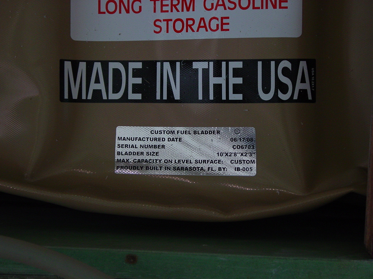

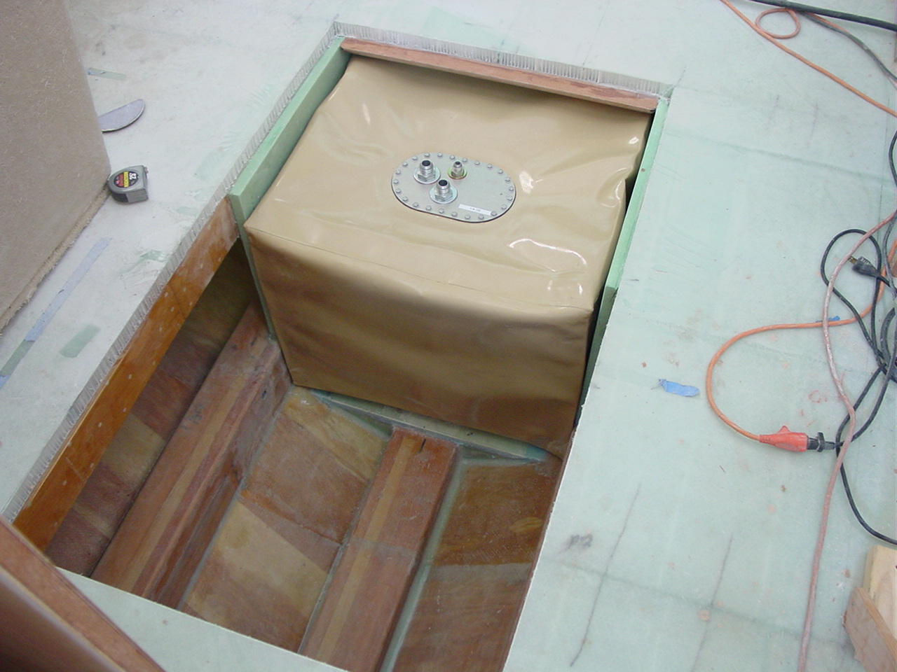

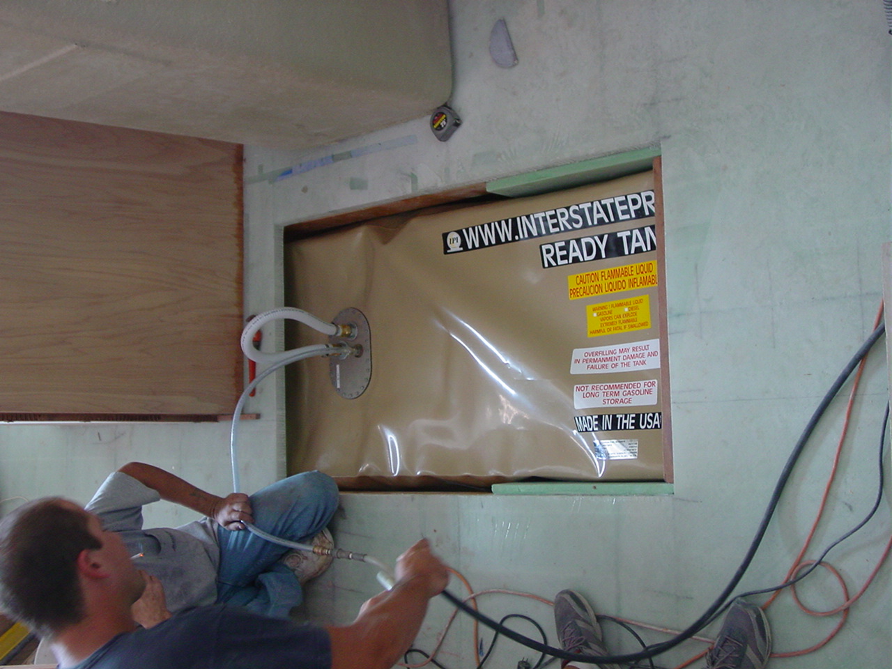

    Bladders are certainly a viable option to move fluids but they should be done "right". I recommend using ones custom made to fit the coffin they are going in, and that coffin has to be strong enough to support the load. "Pillow", or empty bag bladders can have sloshing issues but there are porous foam-filled ones available (for both water and fuel) that alleviate that issue. Be warned, they aren't inexpensive, last ones I bought ran about $14-15 per gallon for custom made but they will hold up. I use nothing but bladders forward of midships on our newbuilds but from experience (and measurements) I expect 10G impact loading in those areas. Here's a couple pics of a fuel bladder being installed in a coffin on a fast (47+ knot) 63 sportfish we built, it's being vacuumed down to shrink it. 8 years of service so far with no issues.

    Those look like exactly what I have in mind There is already a good deal of structure in the bow that I think can be easily picked up to be sure we are spanning enough of the hull to spread the forces. I suspect that your boats are a bit more capable and are likely to see greater loads but I would still expect to see some pretty good shock loads in the bow.
    I can't read the end of the URL, what brand of tanks are you using? The foam filled option seems like a very good one.
