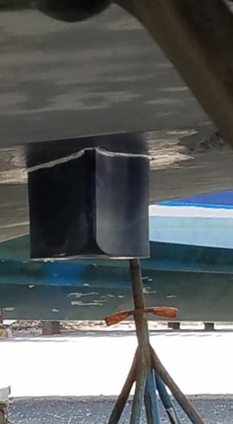

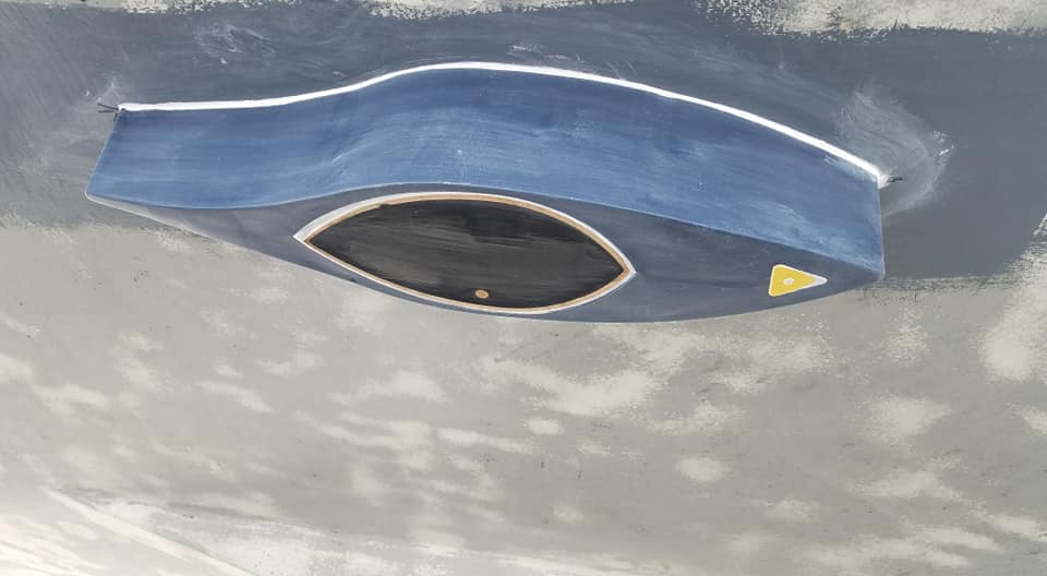

  10. taggeam
    taggeam New Member
    Aug 1, 2018
    8
    08322
