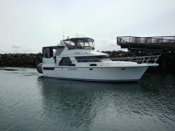

    If you can post a picture of the boat I should be able to tell pretty easily if the waterline has been raised at all.

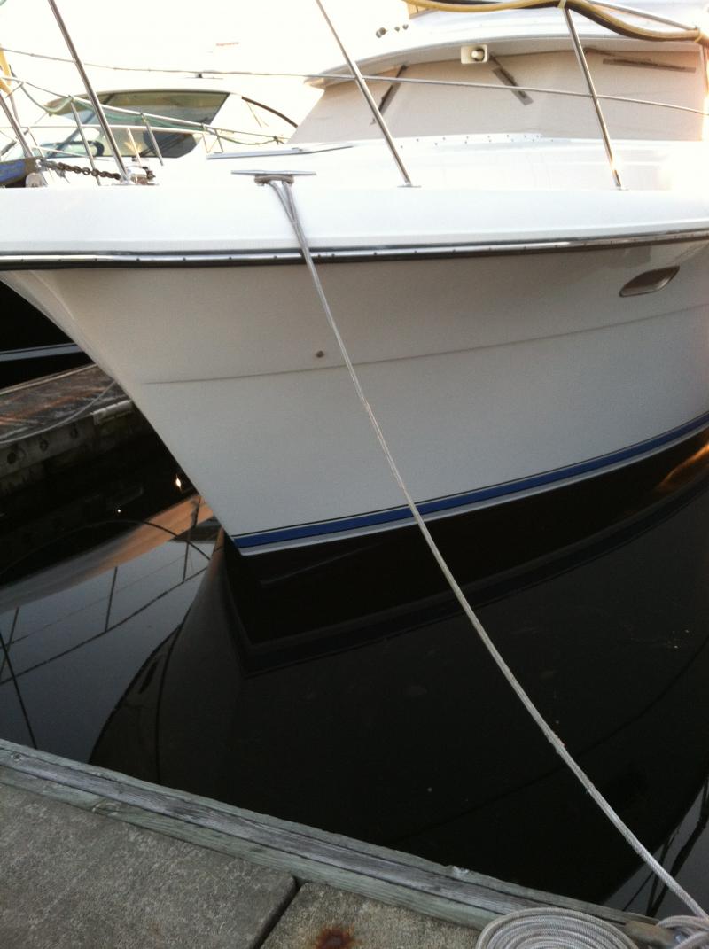

    pictures.......
    Here are a couple of pics.....I know they don't show a great side view, but it's all I have at this point. I will post a better one next time I get to the boat.

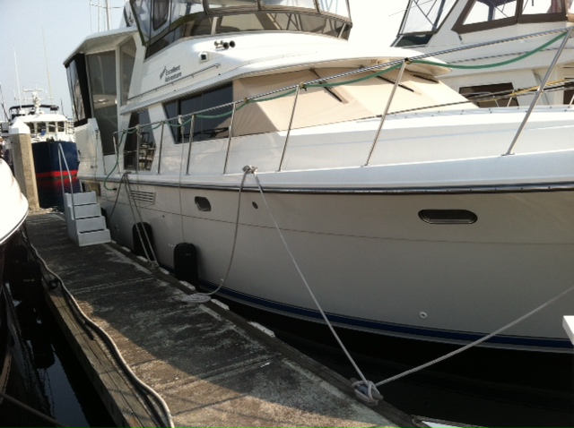

  11. hopper5
    hopper5 Member
    Oct 23, 2012
    102
    Olympia,wa
    One more
    Here is another pic.......I can't verify when it was actually taken. It was before I purchased the boat.....

    Judging by the pics of the boat, the waterline has not been raised. Since the striping is also the Carver blue/grey they used in 1994 that also leads me to believe that they have not been changed.Almost all of the 440s that I have dealt with have been known to look a little stern heavy in the rear when they have diesels and a moderate amount of fuel in them.
    I definitely say weight has some play in the factor but it shouldn't be dragging you down that much.
    I am thinking somewhere along the lines the props have been taken out of factory spec. Its possible one of the prior owners always ran the boat at hull speed and changed the props to maximize fuel efficiency at lower rpms vs. speed?
