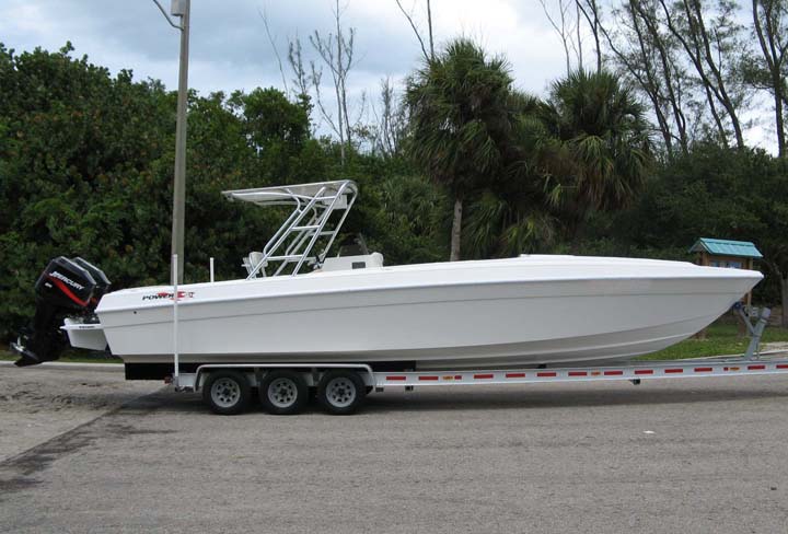

    There is one boat that stands out in my mind as the best center console ever built, however the company discontinued operations in 2005. If you can find one, it will serve you well for a lifetime. They are light, strong, very fast and super solid. The Powerplay 33’ Center Console. These boats were built by one of the most meticulous guys in boat building, using the same race boat methods and procedures that took him to national and world championships. The people that buy these boats are generally go fast guys that had Cigarettes, Apaches, Skaters, etc., but they grew up, slowed down and learned that a well-built boat without all the bells and whistles meant more time on the water. Danny Weinstein, the builder of these boats, employed a number of the original lay-up guys from Apache. They carved the plugs by hand (long before automated CNC routers) and they remain the truest, straightest hulls and decks in the business. The layup and finish is flawless. More importantly, go crack any size wave and I promise you, you won’t have any cracks. Equally, you won’t hear a thing while charging hard offshore. They are solid and quiet. If I sound like a fan, I am. I own 2 Powerplays. Here's my 1991 25’ sportdeck...
  6. YachtForums
    20,954
    ...and here's my 2005 PowerPlay 33’ Center Console…
