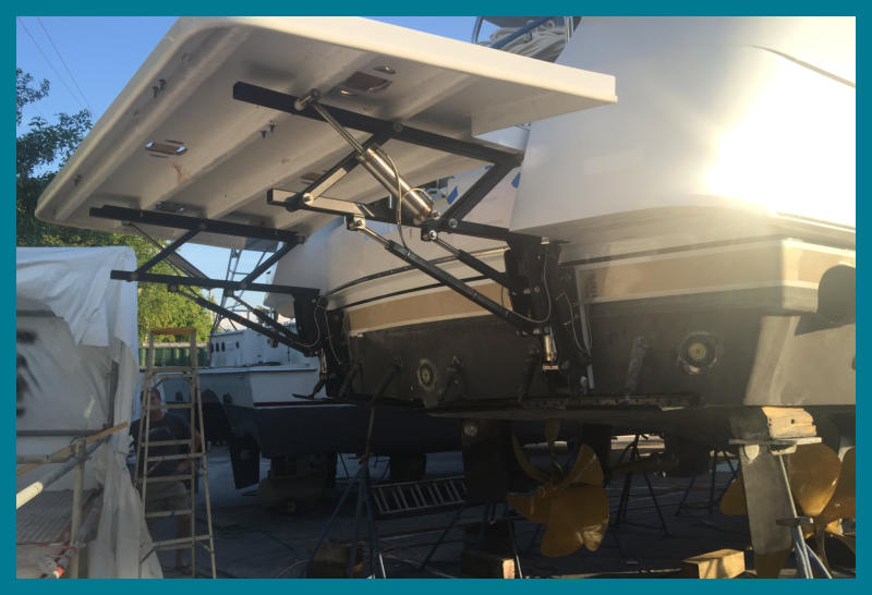

    I sent a quote request to nautical structure. They did the platforms on the later 110s. As much as I haven’t been impressed by their service, we ll see
    the problem is that the TNT second stage puts a new square tube on top of the existing frame to raise the platform higher. That’s why we d loose 3” of float on depth which wont work. They could easily use two tubes on each side of the frame instead of on top of it so the platform remains at the same level. Still going back and forth with them but it s a slow process

    I talked to them today… close to 100k plus install and that s reusing the existing fiberglass platform which is fine.
    will try to with with TNT to fix the existing issue.

    I was thinking (it happens);
    Are there any mods so that you would keep your service swing that you have now, then during ships movement, be able to raise up a good bit further out of the wash?
    I'm sure this would require some longer travel cylinders and maybe longer hotz arms but still,,, an idea??

    yes that’s what they call second stage. They had another support on top of the existing and then a pair of cylinder raise the platform another 15” or so. Problem is that with their standard setup you loose 3” of float on clearance which will not work for us. They re trying to see how it can be adapted. I have an idea but waiting for them to come up with a solution… from their website.

    My idea is to use two support frames in the platform straddling the existing main support and lift tubes. The new pistons will have to be offset but that’s no big deal
