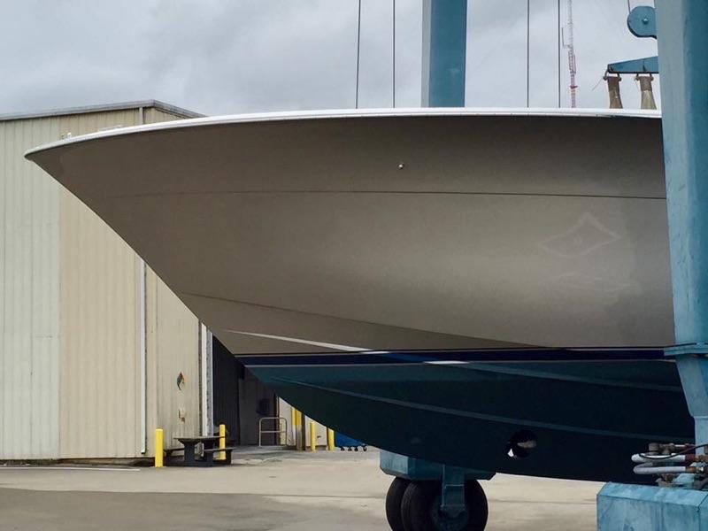

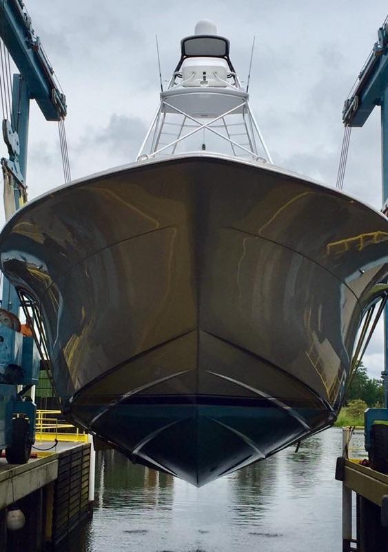

    Here are some pics of a new Hatteras that has a nice clean thruster install. What is possible issues with this type of thruster tube finish?

    Non tear drop is fine. The labor hours seem high. Why not just use 1 of the sidepower dealers to do the entire install?
