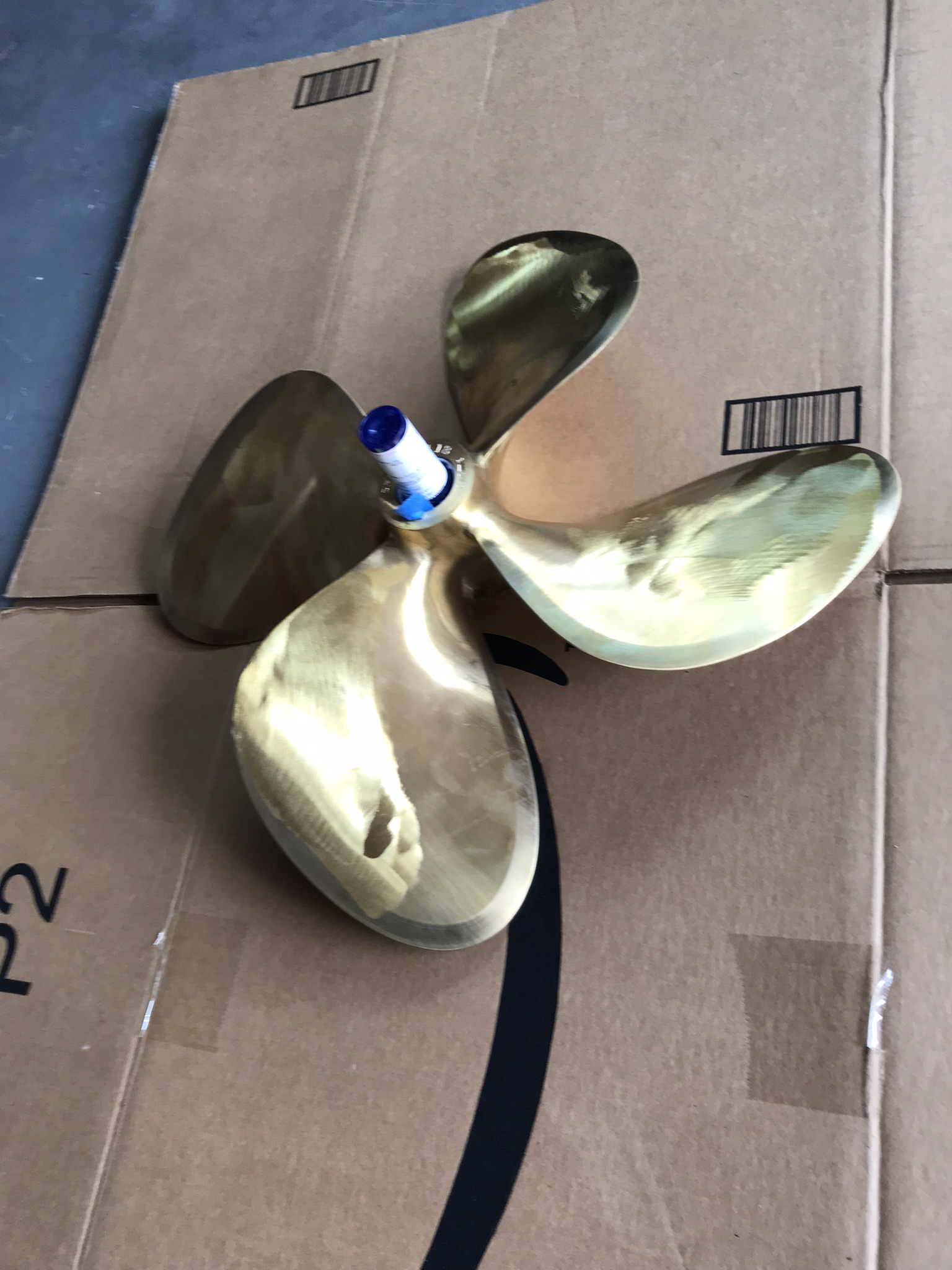

  6. Norseman
    Norseman Senior Member
    Feb 24, 2005
    3,582
    Palm Coast, Florida
    F9FAE94C-E121-43F7-B959-8021D68E7ADA.jpeg Tuned and balanced spare prop

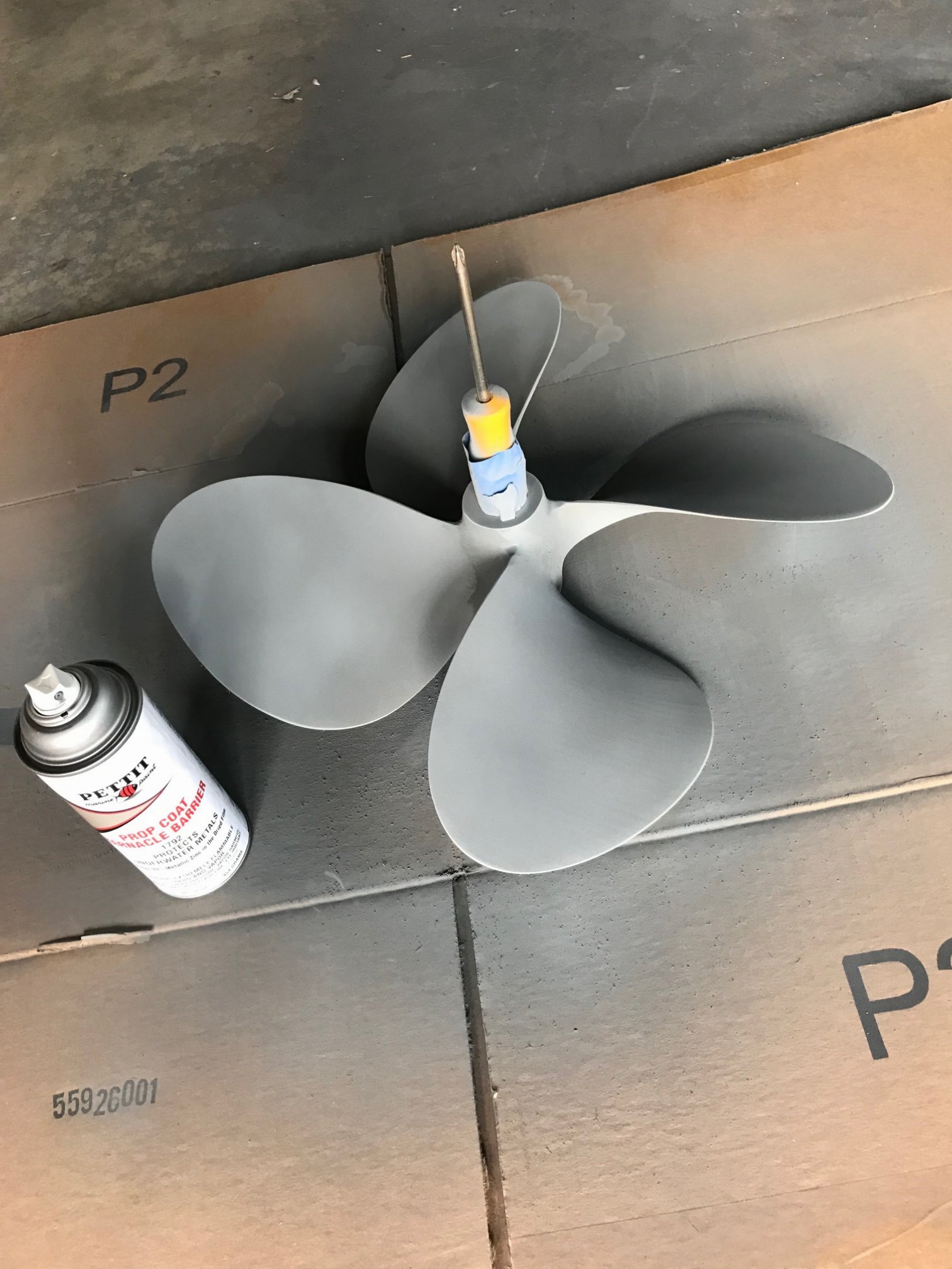

  9. CSkipR
    CSkipR Member
    Aug 16, 2008
    965
    New Smyrna Beach, Fl
    I've had the Pettit Prop Coat on my props about 15 months. Diver came first time since November 2018 and had no growth on the props of course water was cooler. So far very satisfied with this product. I try to run the boat every 12 days and do it most of the time and this helps a lot to keeping everything pretty clean.

  15. Norseman
    Feb 24, 2005
    3,582
    Palm Coast, Florida
    This one?
    Yes, cheaper but thought I would try Petit first, they are the grandmother of antifouling, $14 more for a Petit spray can is probably a good investment, if not, I will do Rust-Oleum next time.
    (Or one of you guys with a twin boat use each product on each prop, then compare 18 months later..:cool:)

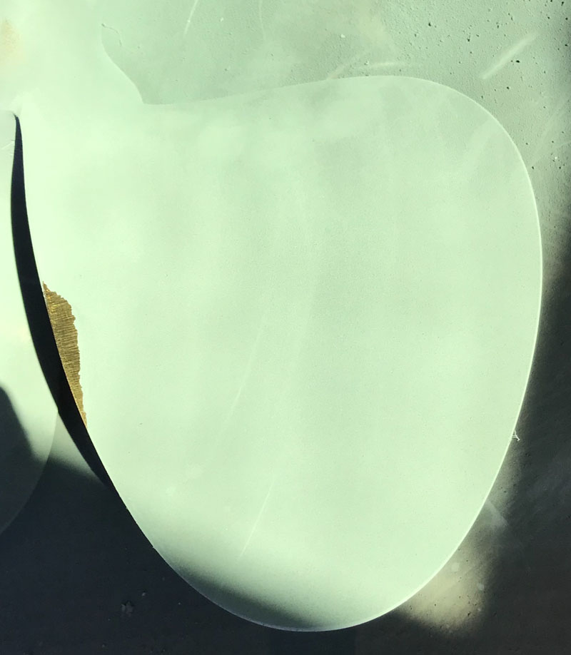

  20. Norseman
    Feb 24, 2005
    3,582
    Palm Coast, Florida
    Paint did not really harden and not sticking to the metal as advertised. Let it dry in the garage 15 hours, then used a piece of dry paper towel this morning to carefully wipe the dust off, and the paint comes off like the skin of a rotten apple. :mad:
    Possible classic case of me spraying on too many coats, or too thick coats.
    Prep was careful with an acetone wash.
    Doubt I will put this prop on if the paint is not hard as rock tomorrow.
