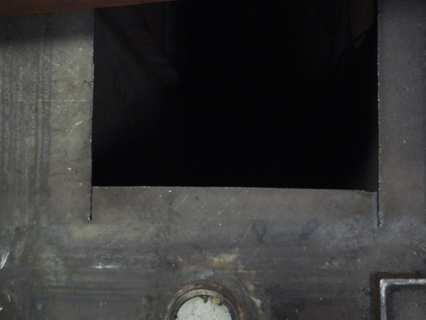

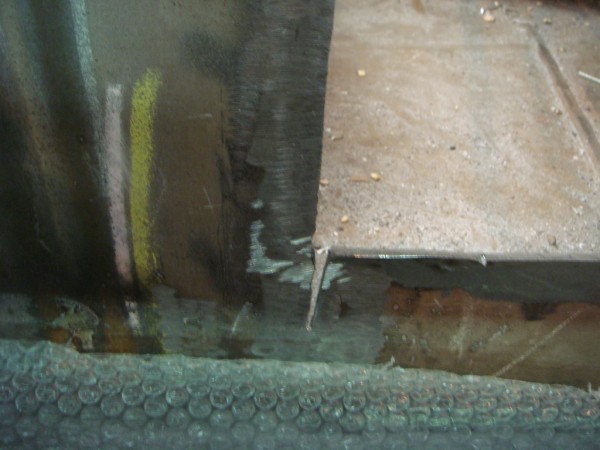

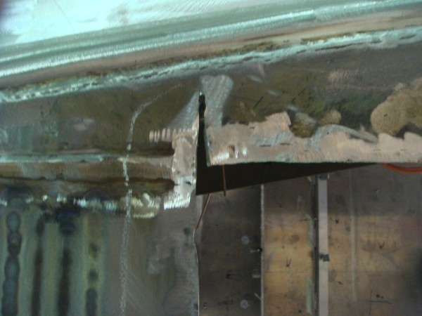

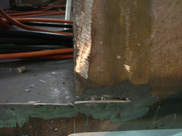

    Here are a some photos to show what I have to deal with on one project I am involved with.
    The third photo down is actually a correct procedure as the horizontal cut line follows the route of a weld through an existing shell plate joint.
    LROS will normally accept the others if the longitudinal weld seam exceeds the insert length by 100mm and a new development as of today after more complaints they want to see each corner X Rayed when no radius is employed.
    MODS: If this is too much a hijack of the original thread please feel free to move or delete this post.

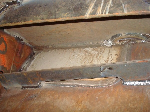

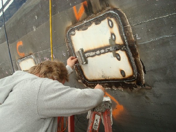

    Well, as long as we have hijacked this one, let me add to the collection of hull repair examples. Here are a couple of pictures of a lloyds approved insert that pretty much covers all the possible configurations. It overlaps a stringer, has no edge on an existing weld and penetrates a tank. I didn't measure the radius but it appears to be around 100mm even though the plate thickness is 6mm. Both sides of the insert are shown. The gentleman in the picture is flaw checking the welds acoustically. The lower picture is the internal side of the patch viewed from inside the fuel tank.
