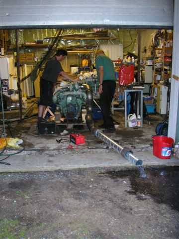

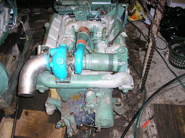

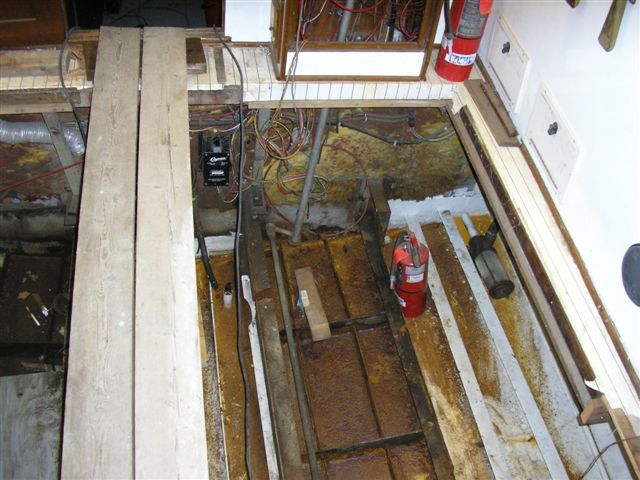

    Now the fun begins work to assemble the engines are not so easy with just a manual in English, but I will not do it myself so it will not be done

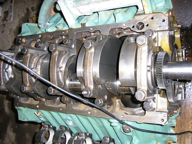

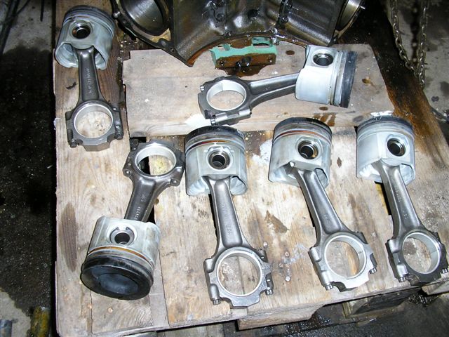

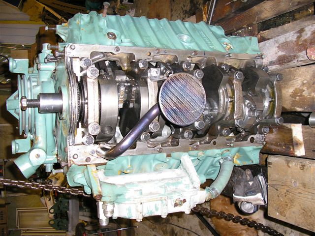

    I am not sure what stage your project is actually at but would advise you to keep your engine parts as clean as possible during the rebuild.
    The smallest piece of grit or dirt can and will scratch your bearings and or crank pins, if there is foreign material between the shell and conrod you can have a tight engine and damage the bearings as well.
    Always use lots of clean lube oil to lube everything as you reassmeble it.
    Having soft clean non linting rags is also a very handy thing to have when doing such major work.
    I was a time served (10,000 hrs) diesel mechanic before going to sea and during that time saw a lot of good engines damaged by the things I have pointed out above.

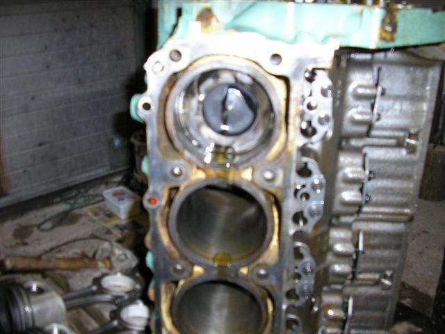

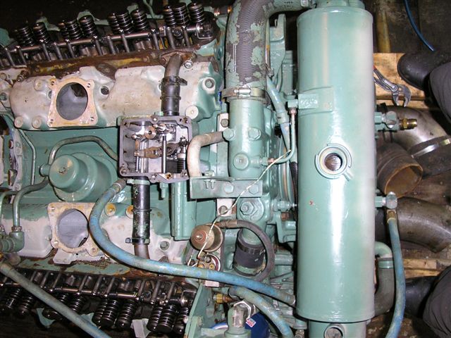

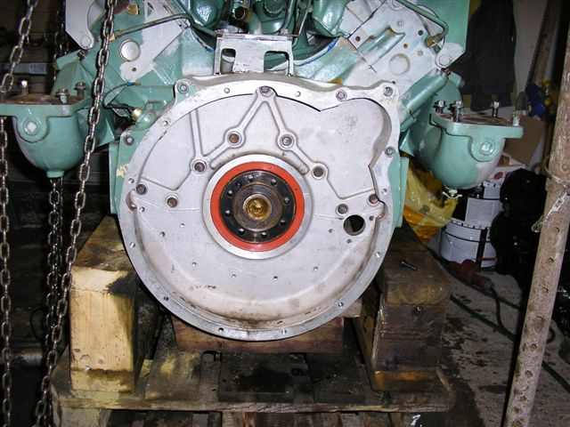

    Thanks for the tips I've blown everything clean with compressed air as it was in the manual these images are from 07 so I've had possibly the engine and drive for about 70 hours I've had some trouble and get good help these engines Detroit Diesel serie8, 2l is not so common here in Sweden, these engines are four-stroke

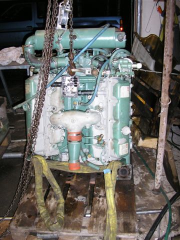

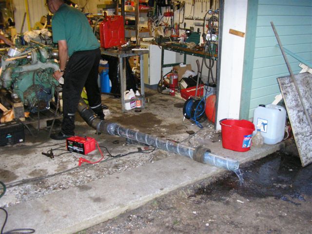

    Engine overhaul

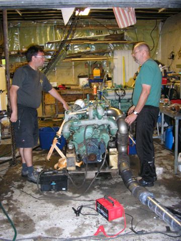

    Slowly but surely, the engines soon ready for test start Check out the strong lady :)

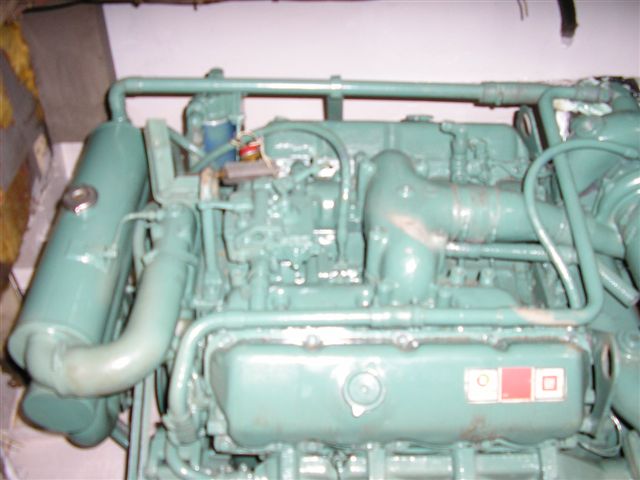

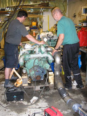

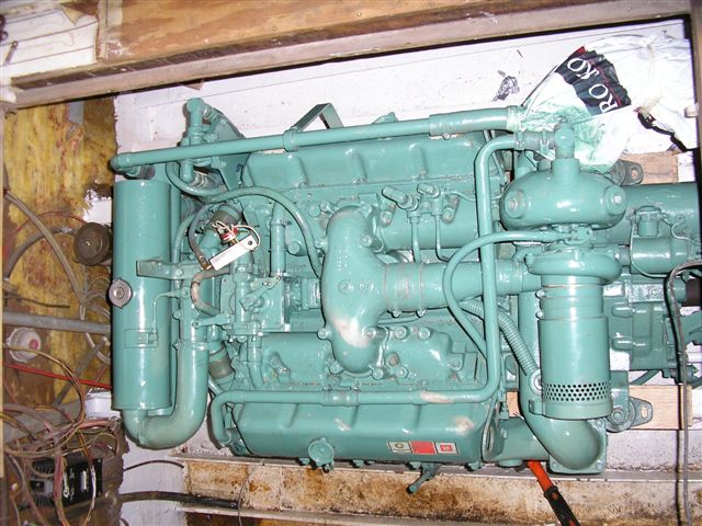

    Starting
    Finally a late night in August, I again hear the sweet sound of a real diesel engine

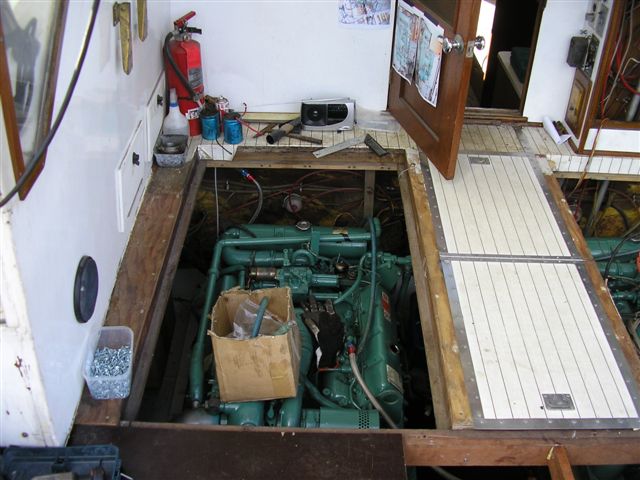

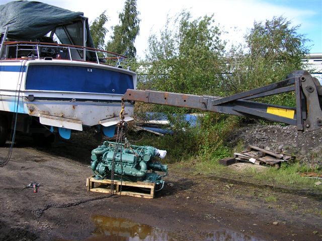

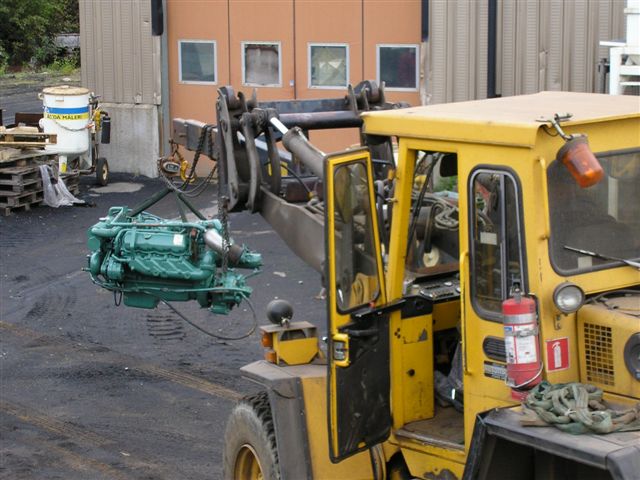

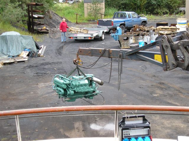

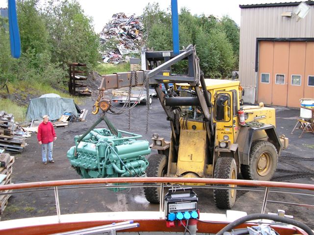

    Incorporation of the engines
    After the engine has been painted it was time to assemble them into the boat

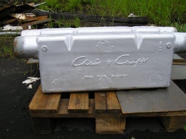

    Muffler
    Amazing... you do not quit.

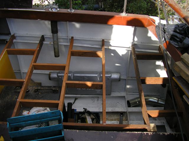

    Dou yoruself a favor.. get rid of those loud heavy original miuffler and get a set of Centek lift mufflers.. boat will be very quiet.
    Those origianal mufflers are the WORST.. heavy and loud.

    Mufflers
    Well'll replace them though I like the sound of them looked at some of Vetus have in their range

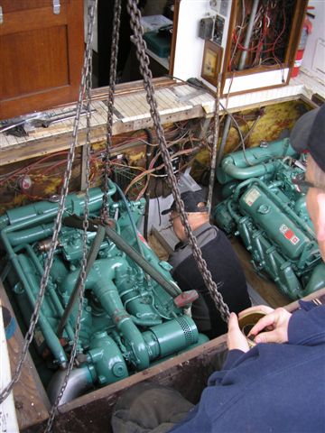

  12. Oneiros
    Oneiros Member
    Dec 17, 2006
    299
    brumm brumm hihi

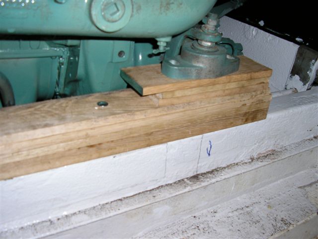

    Now it is down there in the engine room, I mounted them on oak planks good insulation against galvanic currents and sound

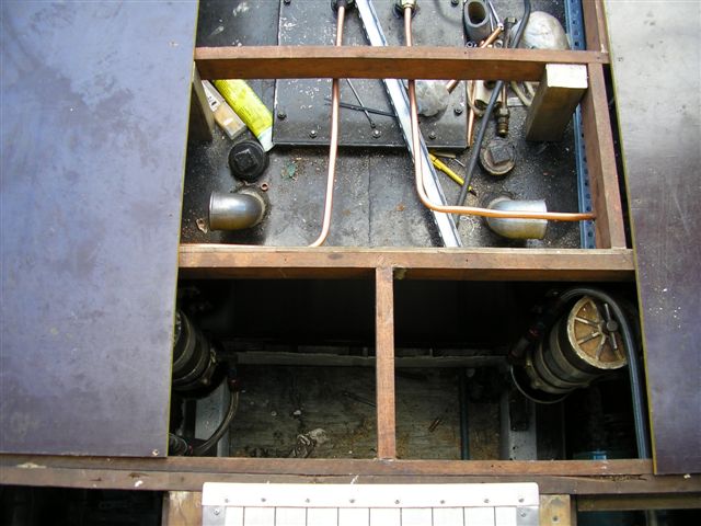

    after deck

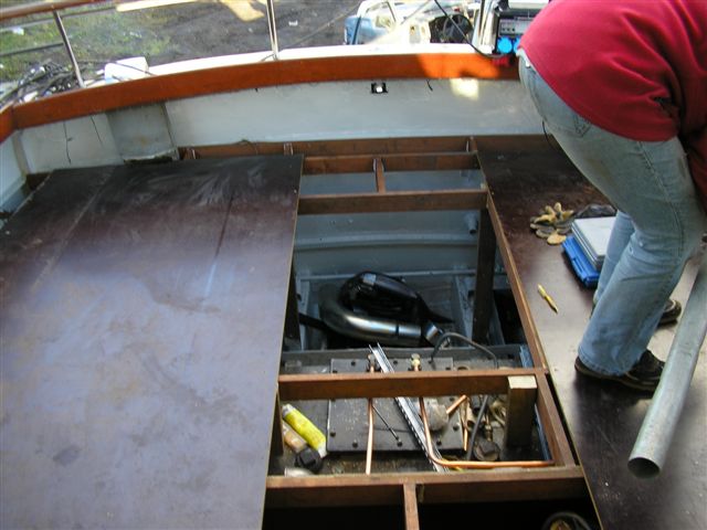

    hi new aft deck I use mahogany and waterproof plywood thought it was great hope to bring a teak deck on top now, I only have a carpet but it is ok

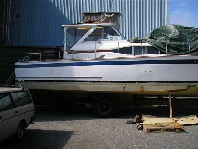

    Hi Thanks for the always fun when its work is estimated at 05 I bought the boat and I have been renovated since then, but we go with her every season there are not many roamers in Sweden so therefore I like this web page

    I would suggest a healthy dose of skepticism about those guys. The picture of a failed piston crown is attributed to "detonation" in a diesel engine. :rolleyes:
    The failure was due to a faulty injector and/or overfueling in that cylinder. That type of crown failure is a classic example of over temperature and melting that leads to piston siezure and liner cracking.

    Hello, you're right, I and my mechanic has been laughing a bit at these pictures, but 8.2 liters DD is a complex engine and it is difficult to adjust but I bought all the tools on e-bay so we could do everything Luleå is an industrial city so there are many who can repair two stroke diesels

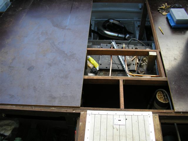

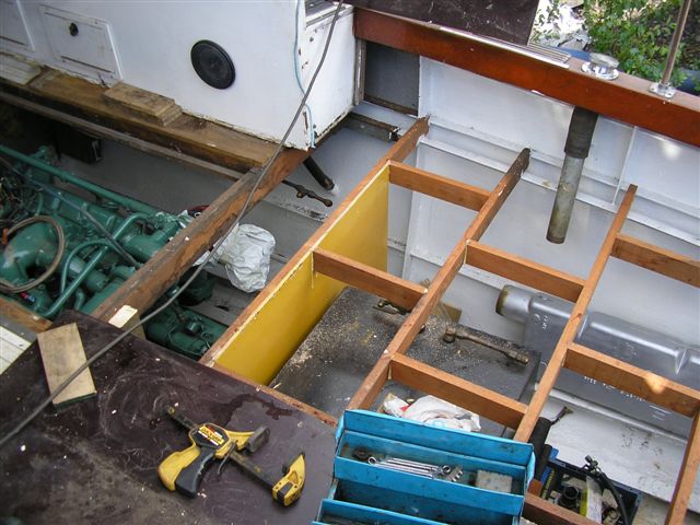

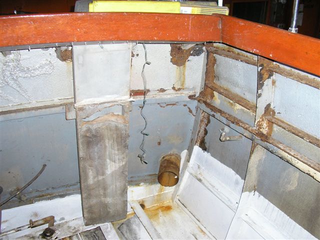

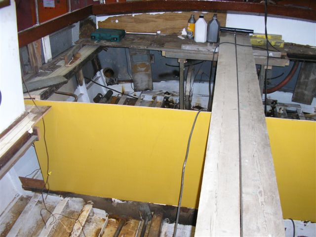

    some pictures of some work on the aft deck I have mounted a wall between the tank and the engine room area
  18. Marmot
    Marmot Senior Member
    May 20, 2007
    3,300
    9114 S. Central Ave

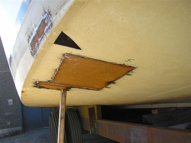

    It might be too late but you should radius the corners of those hull inserts.

    I believe ABS rules for steel vessels <90 meters calls for a minimum of around 5 times the plate thickness for the corners of welded inserts.
    And I just checked, IACS standards call for 5t with a minimum 100mm radius. The last revision was in 2008 so the Lloyds man must have something the rest of us don't have yet.
