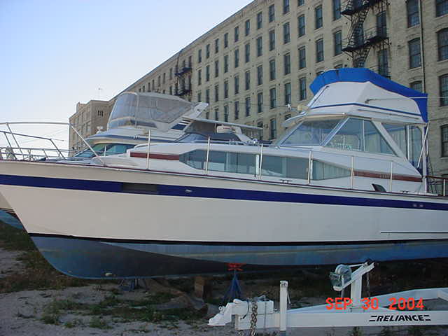

    Everyting start with the internet found a project on boattrader.Pic from milwaukee skipper bud

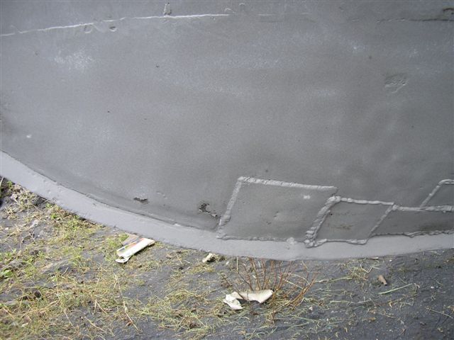

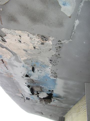

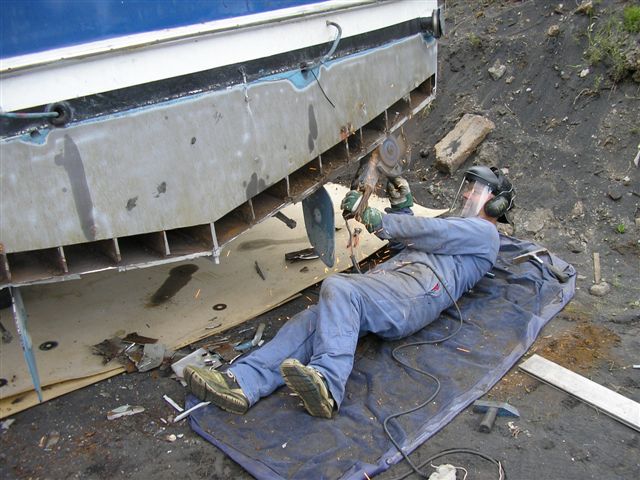

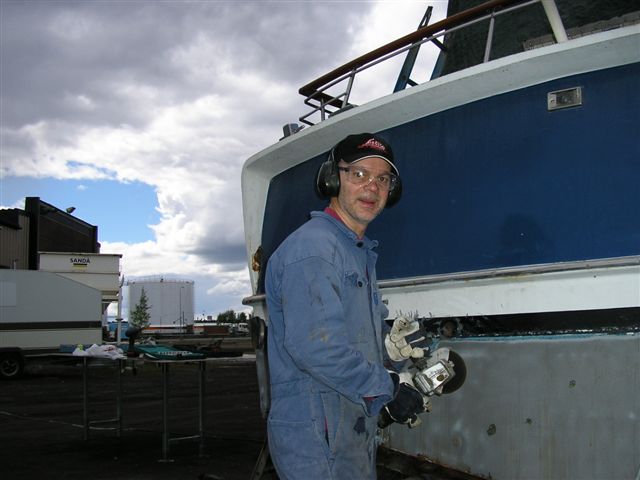

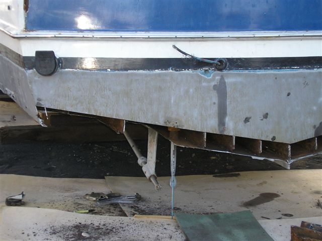

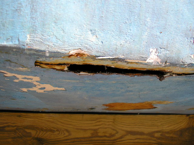

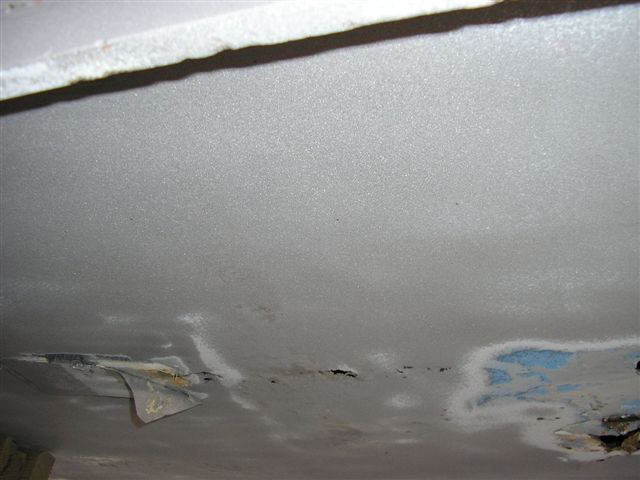

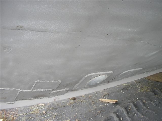

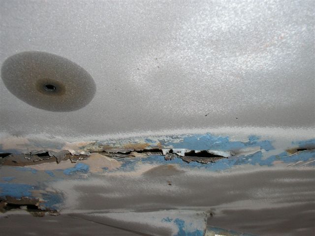

    No, she is built of steel the trip from Milwaukee to Jacksonville cost about $ 6500 from Jacksonville to Germany went to $ 6900 and the last bit until luleå cost about $ 4000 I paid $ 15,000 for the boat.
    But it is worth every dollar our dream boat, my wife loves her.
    No, we bought her on the internet but unfortunately, so we hired Swedish living in Florida, a real rogue who cheated us of $ 5000. the images are from the winter rust, but oh Well, this is just the beginning when we had blast her so we could see more of as we Swedes say American carelessness double sheet bad veldings.min friend a good welder replacement 20m2 by the port side, I had to pay him $ 15 per hour quite ok

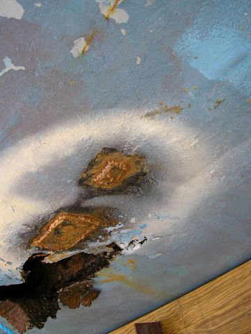

    more pic

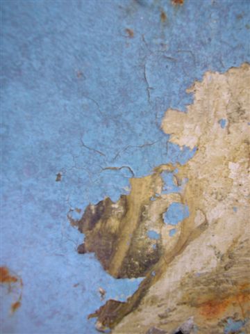

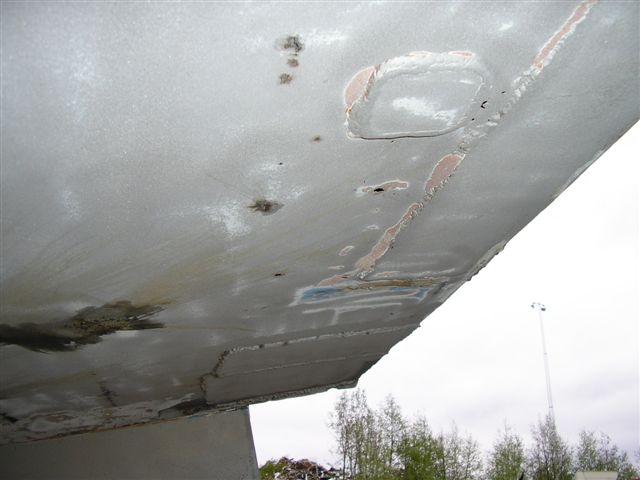

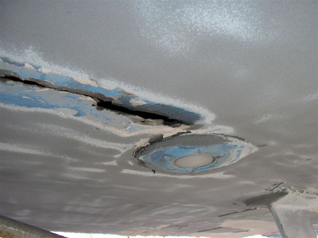

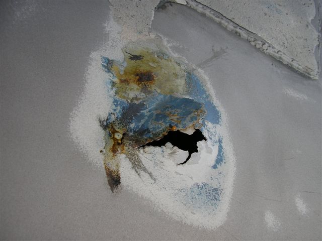

    hi more pic lots of rust when sandblasted
    look at the last pic double plates no way!! I wouldn´t done so

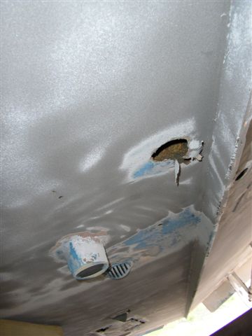

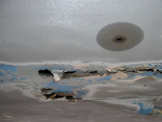

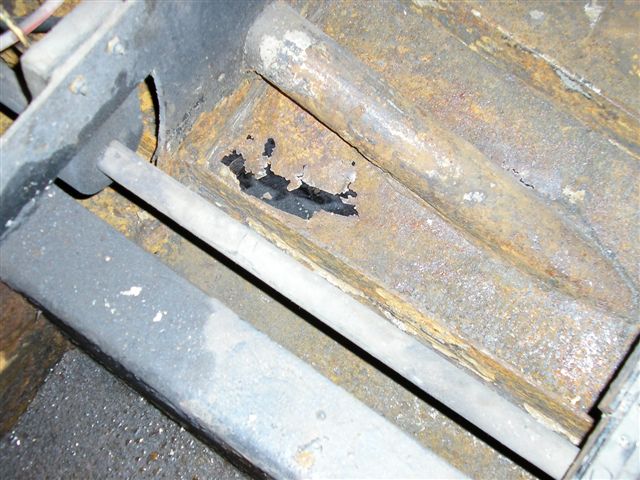

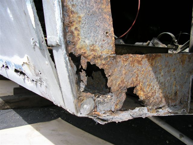

    More ....

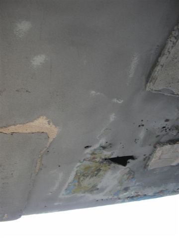

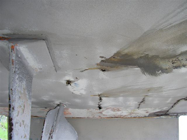

    hi
    Now you see how she's been cheating repaired double sheets should not sit on a boat Pic 3 ???
    hehe look like plastic .....

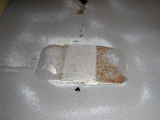

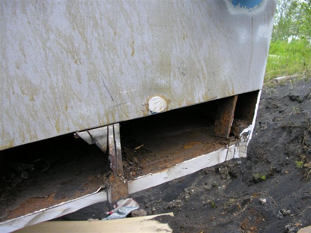

    Now the fun begins work to cut away any metal that is rusty.one week job dirty but so fun hihi
