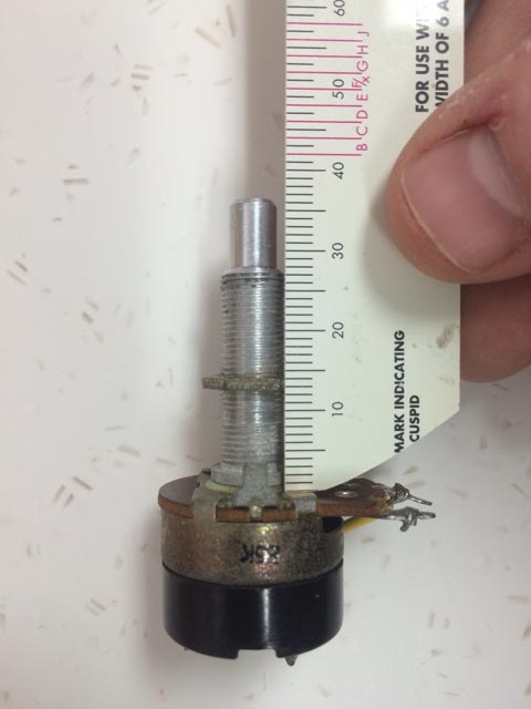

    Here are the images of the "switch". There is electrical wire soldered directly to the switch, which goes back into the nether regions behind the cabinet and into the aft bulkhead. Ill try to see if this leads to another component when I go down tomorrow. For now, everyone I emailed on this pot has told me that this is a custom part.
    It does have an integrated "On/Off" switch with it (the black section on the back) and the measurements are in MM if anyone was wondering.

    Long bushing, that makes things a bit more complex.
    That the potentiometer is ganged with a switch does not add much further excitement.
    If we ignore the bushing length for a moment, quite possibly:
    Alpha (Taiwan) RV24A01F-10-15R1-B5K-3
    Should tick most boxes including the markings and layout on the back, BUT the bushing is way too short. (6.5mm)
    At that point I would ask myself If I just want to OR of have to replace.
    Then I'd think about switching parts around. Usually thats not too hard. Bend open, switch innards, bend closed. If the new innards don't fit go back.
    3 of them from mouser.com within the US for ~$11 USPS snail or ~$15 UPS/Fedex, not too bad for an experiment. Start training with the additional new one. ;)
    Double check first if yours are really 5k Ohm tough. Where three pins are in a row the two outer ones should read about 5000 Ohm with a multi meter. (+/- 20%)

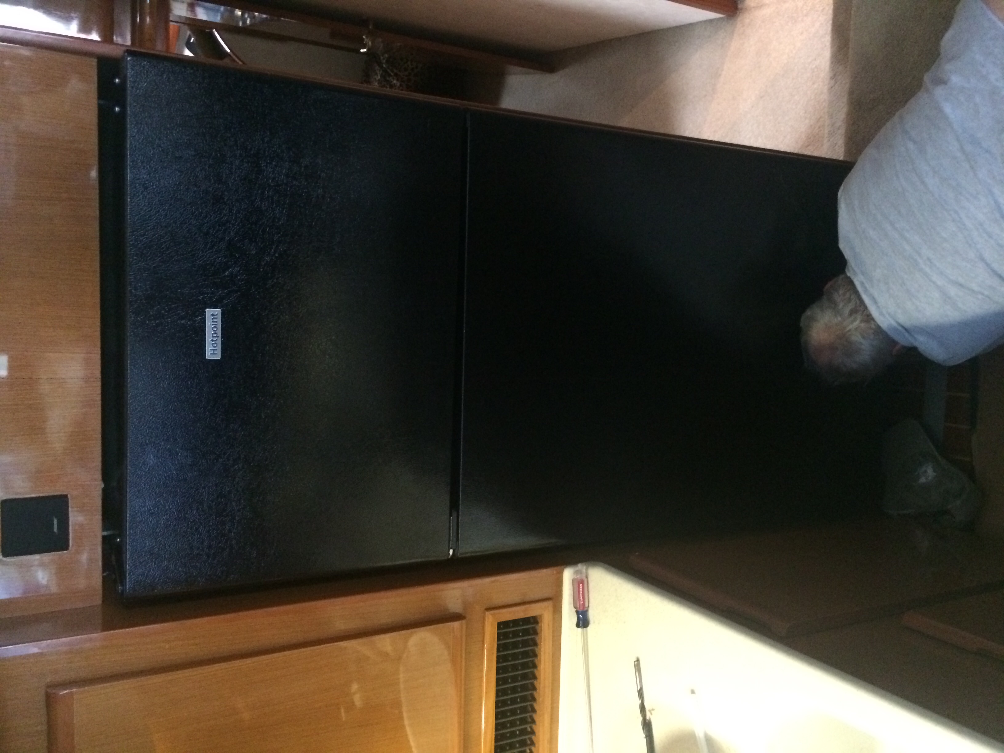

    I have been looking at a few from GE and whirlpool. The size is 28" wide, 64" tall, and 30-31.5" deep. Once you find something that fits, you're golden. I'm choosing one with no ice maker and wire racks. More freezer space, no chance of breaking the shelves, and it's cheaper.

    Did the fridge dance. Got it all installed, had to lift it on mahogany rails to make up for the shorter height.

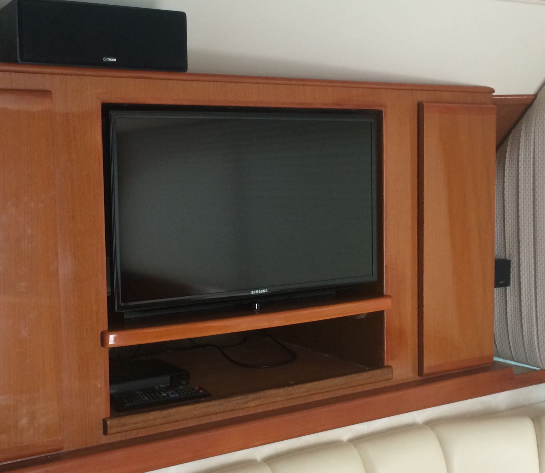

    Also got the new salon TV installed. Used the existing space with the teak bullnose to keep the lines somewhat normal. Added a DVD player and Apple TV. Came out quite good if I do say so. Now I just have to add the lexan below.

    Here is the TV setup
