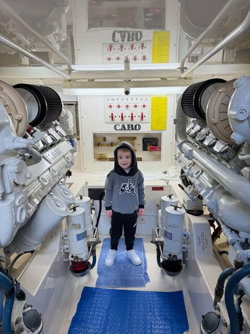

  20. CaboFly
    CaboFly Active Member
    Aug 24, 2018
    285
    Seattle
    I asked my mechanic and he indicated no issues standing up in my 48 Cabo
    gr8trn, leeky, YachtForums and 3 others like this.
