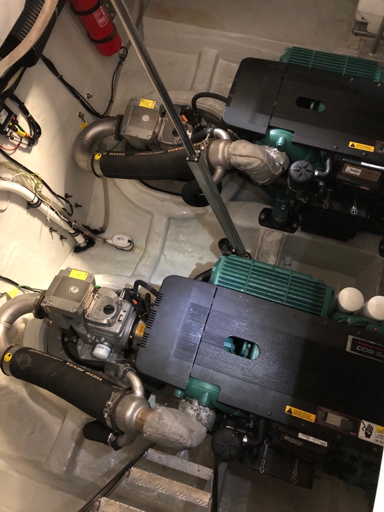

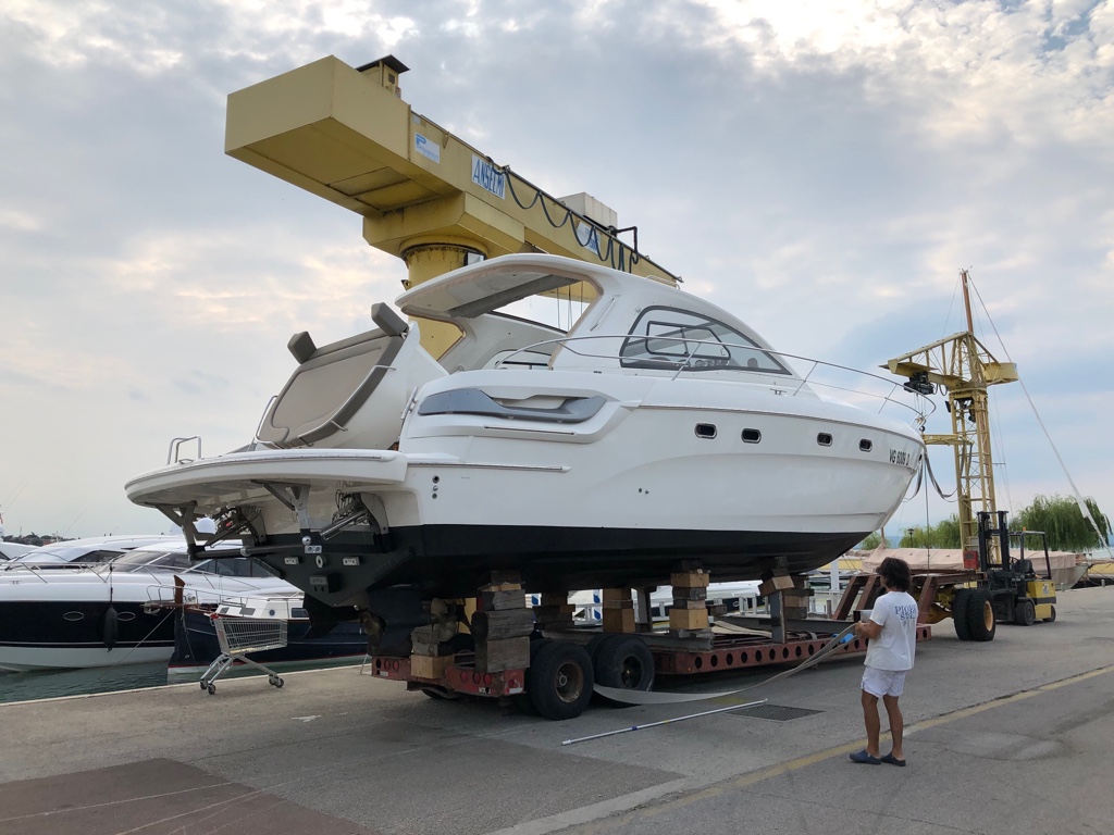

    If you want a (relatively) small boat with a good sized engine room, I’d look at a Bavaria.
    We currently own a 2012 Bavaria 43 hardtop with IPS600. Engine room is huge (also on the smaller models) and the boats offer great value for money, especially with their roomy interiors (beam is 4,41m) and just overall space on board.
    There are 2- and 3-cabin versions available, but we were looking for the 2-cabin style.
    The successor of the 43 sport/ht is the 450 sport/ht. It basically is the same hull but revised design. Oh, and the engine room is smaller now (a lot less headroom) as the tender garage/storage compartment is now fixed and doesn’t open up completely as it does on our boat.

    Engine room access (sun pad & storage compartment lift up):

    That s an engine compartment on that Bavaria. Not an ER. Have to move everyone off the cockpit is a pita. Then a ladder landing on the hot exhaust and no floor boards...
