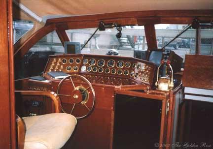

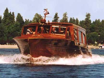

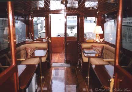

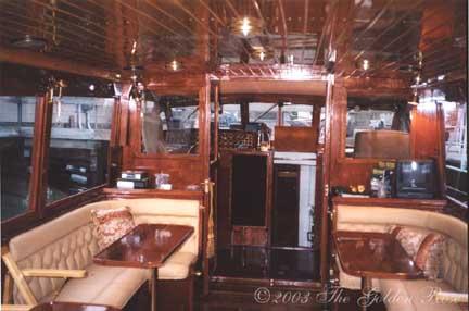

    Be prepared for replating if hull has been neglected. Proper maintenance (as always) will save you down the road. In salt, I highly (highly) recommend stripping bottom and applying cold tar or INterlux 2000E Epoxy (see Technical Forum for articles on these critical issues: http://www.geocities.com/alloyed2sea/TechnicalForum.html). ANyway, have included photos of the coolest CC water taxi I've ever seen - a wooden 1953 Constellation 38' - majorly customized for the job.
