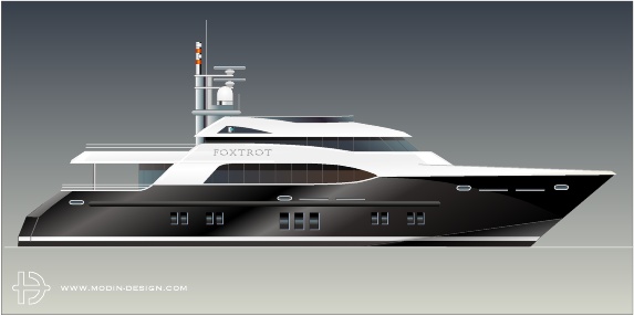

    For those who prefer a monohull as The Perfect Yacht I have made a 110´design on the same theme with a raised wheelhouse. Here in Tuxedo Black... :cool:
    /Lars

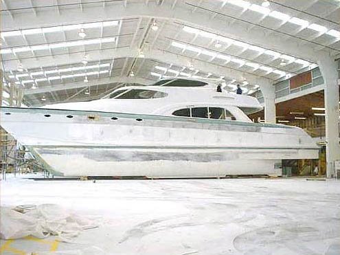

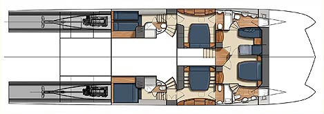

    Good observation Catman! And an interesting question. There are a couple of reasons why the engines are (and appear) to be mounted further forward than one might expect...
    A primary reason is Center of Gravity, but secondary... if you study the artist rendering below, you will see the hull tapers to the exit of the shafts. The props are placed immediately behind this point. The space leading up the buttocks of each sponson becomes progressively more narrow, thus reducing interior engine room width/space. The recessed, flat under-side of the aft deck/swim platform extends beyond this point and serves two purposes... additional lateral stability and a partial planing surface.

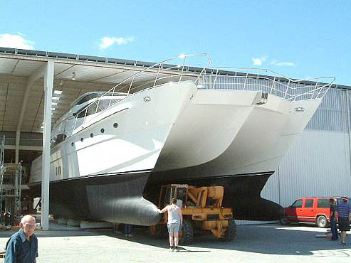

    What is NOT shown in the original construction picture is the bulbous bow extensions that were added to each sponson. I've attached another picture showing their later incorporation. The bulbs were added after the initial sea-trials, when it was determined they would help the cat run flatter and reduce pitching in various water conditions.
    The bow picture below also reflects the relatively narrow cross-section of the sponsons, which is one of the reasons the sponsons have an extended flat running surface under the swim platform. (increased stability)

    In the case of Pacific Harmony's sponson design, the engines would NEED to remain forward in order to accomodate the intake gullet of the jet pumps. The only problem I foresee is the buttocks of the sponsons would need be flat in order to mount the venturis and thrust directors. This would diminish displacement efficiency.
    Because Pac Harm has a deep draft, due to the narrow cross section of the sponsons, the props are not exposed beneath dead bottom plane. This protects the running gear in the shallows.
