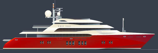

    I submit... the TRY Cat 160; designed by Lars Modin!

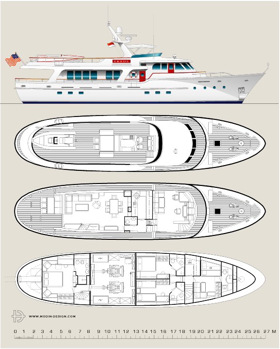

    Tetou, at 26m/85´is my Perfect Yacht...
    I have showed this yacht before, but this version has got a bigger wheelhouse, galley and engineroom. Three important working areas.
    She can be completely owner operated, still has a crew cabin if you like to have a deckhand/stewardess or a captain, or why not a couple?
    The owners area in the stern and guests forward gives some privacy even in this limited size of yacht. Big sun/boatdeck for the tenders and protected walkaround decks makes her safe and easy to handle.
    Built in steel/aluminium or GRP, stabilized and with transatlantic range.
    This would be my ideal live aboard yacht and passagemaker... :)

    The length over deck is 26m, loa is 27m, beam 6.2m, draft I dont remember but about 1.5m. It is based on the same hull as the Diana design for Moonen 85.
    Maybe I can add a scale in the future, otherwise you can do as I use to, measure the bed length which on my yachts should be 210 cm, or just under 7 feet.
    Edit; A meter-scale is now added on the previous drawing... :)

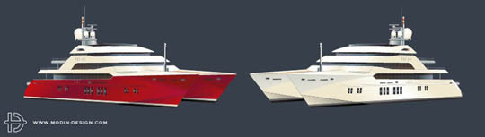

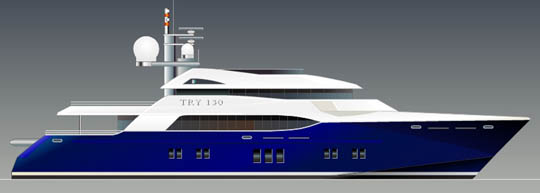

    For the Cat lovers I have now refined a 130 feet version of the big 160 feet Explorer catamaran. One deck less but still with a lot of space and with the hydraulic beach-platform between the hulls aft.
    /Lars

    The difference between a cat and a monohull in movement is that the cat is "rolled" by different waves at the same time, making the hulls move less rythmic which is not always nice. I don´t know if there are stabilizers specially developed and used on big cats, but I have not seen it. I think the SWATH system with submerged sponsons might be a better solution to prevent this rocky movement. There are also other hulls with three or four submerged sponsons that could be good options, so there are solutions coming which we will probably first see on passenger vessels. But if the yacht buyer will go for such exotic hulls remains to be seen...

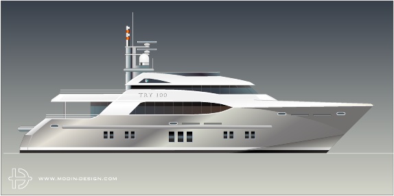

    100´ Long Range Cruise Cat
    The smallest catamaran in this expedition style has a raised wheelhouse with a flybridge on top. This means you have semi-levels up from the maindeck.
    This size is where an experienced yachtsman can handle the yacht without a crew but with a couple of good hands on deck. Still I think it should have a fully fitted crew area, which can also be useful to create a charter income.
    More on this yacht will come as the TRY project is about to become a reality. :)
