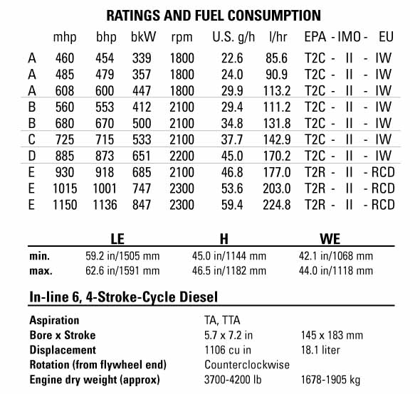

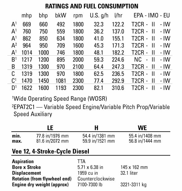

    Why on earth would you chose a C32 rated at 1200hp over a C18 rated at 1150hp for this pod set-up? The C-32 at 3220kg would be a waste of iron at that rating. The C18 comes in around 1675kg. C32 is not the right choice.
    Less weight = more speed
    FYI - ZF developed the Zeus drive for Brunswick (jointly), with Mercury providing the Integration team. It's mostly ZF hardware.

    I've never heard of a C32 ACERT at 1200 bhp. The lowest rating C32 I've seen is a non-acert at 1550 hp. The C32 while being heavier than the C18, would last a lot longer at that HP level, but would have a lot more low-end torque to get the boat on plane and such. I've run a 44' Express with C18 acerts......C18's in a 60' SF is on the small side in todays day and age.
    The Zues drive was a joint effort between Cummins, Mercruiser, and ZF. The drive itself I'm pretty sure was designed by Mercruiser as well as the electronics, the transmission by ZF and the engines by Cummins.....I've worked for CMD for a week several years back running one of their Zues boats for seatrials at the Miami Boat Show.

    Both the 1150 HP C 18 and the 1550 HP Non Acert C 32 are E Rated engines.
    A 1/2 hr every 6 hrs at MCR.
    The 1200 hp Acert C32 on the other hand is B Rated
    8 hrs out of 10 at MCR
    If someone wanted to drop to an E Rated Acert C 32 they could get 1900 hp a side out of the same footprint and weight

    I was reffering to the Cat C 32 (B) ACERT with 1200 bhp, as the Zeus 4000 Pod is limited to 1200 hp max. input. The C 18 ACERT does not seem to have this amount of power. See below, C32 ACERT and C18 ACERT.

    My mistake, thanks for the clarification. Mercury supplies the lower unit/props and controls, ZF provides the transmission for Zeus. I agree that the Zeus product has a much better feel at the helm than the larger ZF Pod, and I would credit that to the Mercury integration team that handled the control side of that program, as well as to their decision to use that oversized hydraulic pump.

    The selection of the B rated C32 would not justify the added weight penalty of that product at 1200hp, as well as the lost space due to the C32 being an oversized product at that rating.

    Note - the ZF 4000 Pod is not rated for an input of 1200hp at 2000rpm, I am assuming due to torque limitations. Check their brochure.

    You are absolute correct on both of your statements. The C18 is the biggest engine, the ZF 4000 Pod can take in that RPM range and the C32 is to heavy. But Cat is missing the V8 and V10 engines in their portfolio completely, like MTU or MAN. That is probably why most SF manufacturers offer their boats with MANs as standard engines in that range (best power to weight ratio). But I do not trust those MANs (Italian engines !!!, Leporello / MAN SE). I only like the big ones (mediun speed) and the very big ones (2-strokes). Cat should offer V8 and V10 versions of their C32 family.

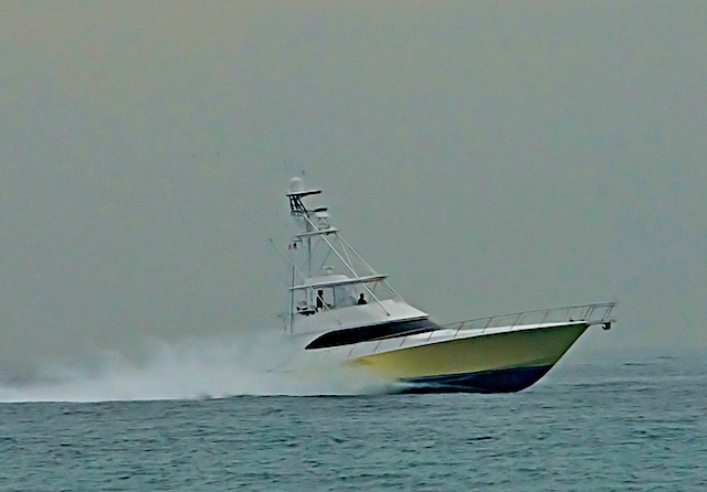

    I ran across the Slane 62 while searching for more examples of pod equipped SF. Apparently Tom Slane is the grandson of the Hatteras founder. He and his father have been rebuilding/customizing old Hatts and have built some pretty interesting express models. They are now looking for a buyer for their first new build. If the advertised numbers hold up, this will be a good example of an "evolved" SF.
    Slane 62

    It looks very fuel efficient according to the numbers 2 gallons per mile at 30 knots....... Why Volvo's is another question. I would think the Cat C18/ZF would be the easiest for servicing reasons on a traveling SF. But I think Zues would be the best all around due to it's integration, transom exhaust, and features......
    BTW, the ZF pods and possibly others can be mounted on the deadrise without changing the hull design or whatever. But you really DO NOT want to. What happens is if you're running at cruise and make any more than a very very slow turn, the whole boat leans over on one side of the vee (inside of the turn) of the hull and then radically turns (like full rudders over on a traditional inboard). It's a very strange handling and most people wouldn't like it. But there is little in-between, you either get a very very slow turn or an instant and hard over turn......
    The main issue I've seen with pods, besides the complexity of the system, is any growth on the propellors and stuff REALLY effects performance, much more so than with inboard propellors. I've seen just scaling on the propellors knock 250rpm's off top end.

    On any new project, fuel consumption figures are only estimates until they actually test the boat - I'll wait for the test results to see if she can really hit those numbers.
    What Zeus Pod/Power package can be used in this application? They are running twin Volvo D13's at 900 hp and I don't think the Zeus combo of QSM11's at 715 hp have enough grunt/power for a 62 footer, and there is no talk of triples.
    Fuel efficiency at 30 knot cruise seems to be a marketing key, and it will be interesting to see if they can get there with the D13s. I'll be rooting for them to hit that 57,500lb. weight target.
    I agree that a 1200hp/ZF 4000 Pod would be a more logical but more expensive package. All pod systems struggle to get enough blade area for the power installed, as they are essentially diameter constrained design but make up for it with two counter rotating propellers. I think IPS has a better chance of optimizing the propeller design at the lower 900 hp than the 1200 hp ZF set-up.
    The turning ability of pod driven boats is one of the key selling features. With the electronic helms, the steering rate as well as the individual pod angles can be programmed to lessen the effect of "lean" to some degree, but it is definitely fun to snap a U-turn at 40mph on a pod boat, as long as you give your crew some advance notice!
