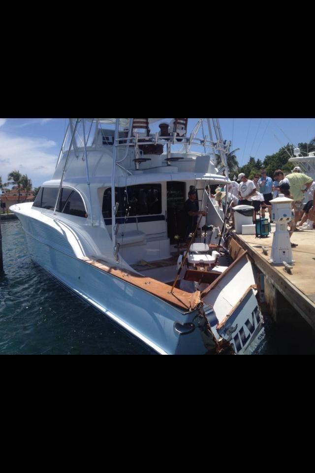

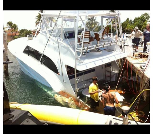

    here are some pictures I saw on another forum of the 68 sculley "Silver Fox" that crashed into a pier at sailfish marina after one of its engines got stuck in reverse. sad to see this happens and it shows that it is always necessary to have emergency shut downs on the bridge. ot has been reported that fortunately no one was hurt
