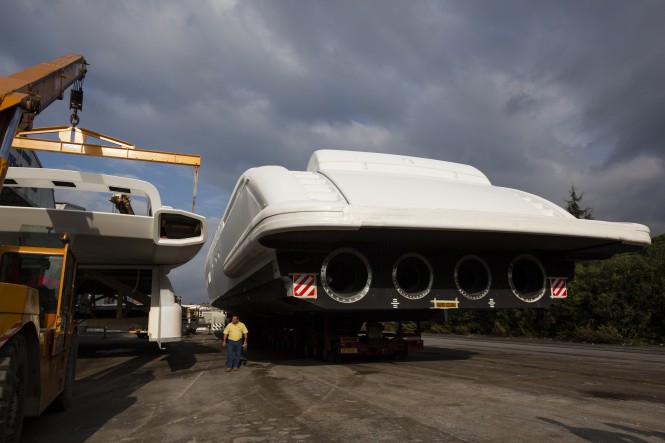

    Just trying for a real world comparison, Motor Yacht Pumpkin received a refit to optimize slower speed efficiency with the use of four MTU 16V 2000 M94 2600hp engines - smaller replacing larger.
    Just curious if you would offer something that could efficiently occupy the same space.

    No.
    Website:
    Mangusta 165 | OVERMARINE GROUP
    The website configuration shows the normal engine configuration.
    Motor Yacht Pumpkin received a refit using a four engine configuration and improved water jets.
