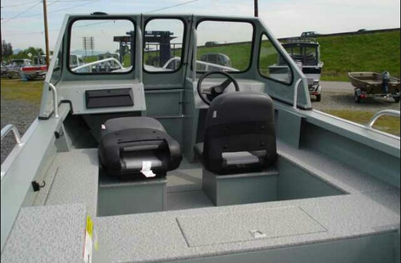

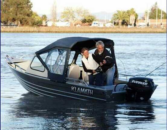

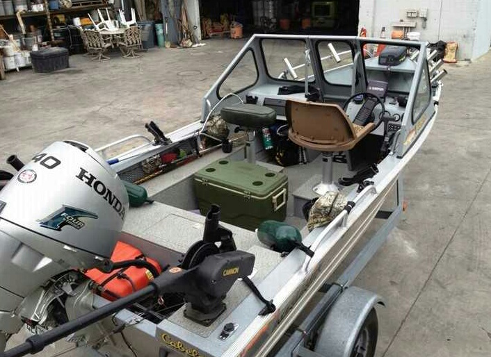

  17. Fish Catcher Jim
    Fish Catcher Jim Member
    Oct 4, 2014
    112
    4 Now Michigan
    I have been looking at these for a replacment tender down the road. Both the 15 and 16 are very light and one of the 16 models has an under transom storage where I can instal a solid permanent fuel tank.
    I like the solid winshield and full enclosure top for the long fishing days. These are all 15 footers.
