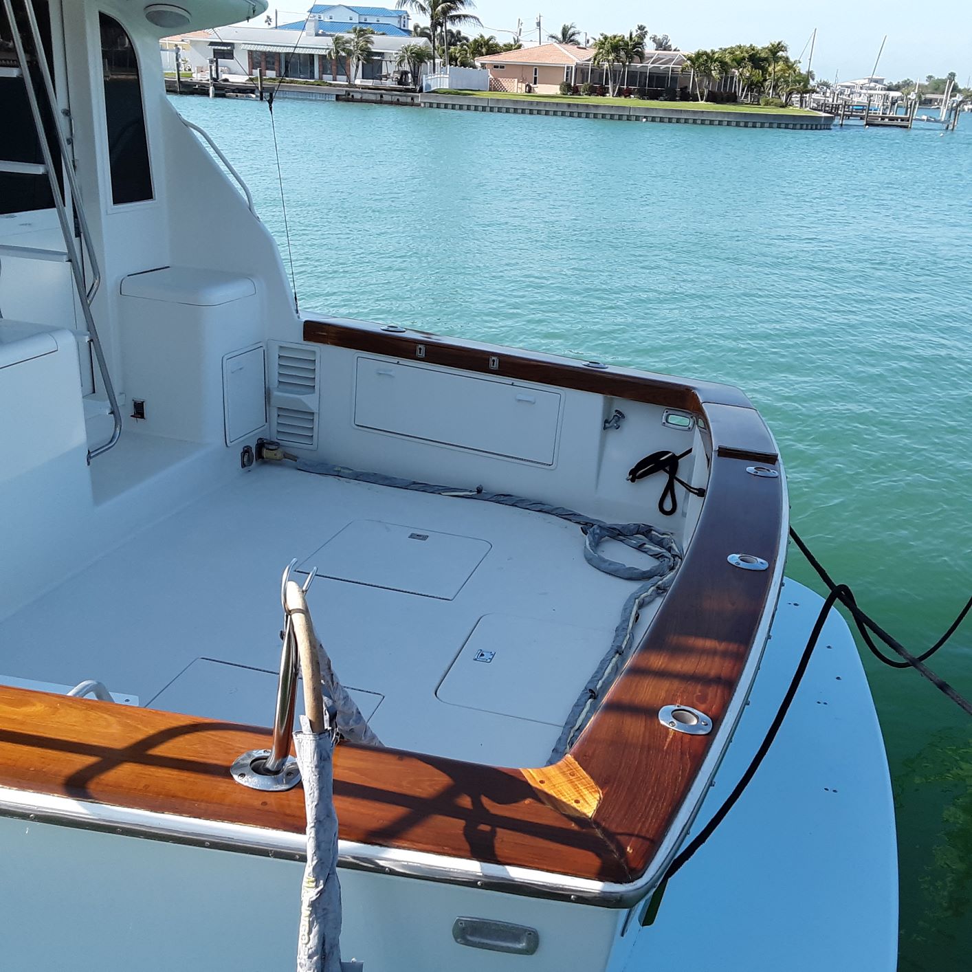

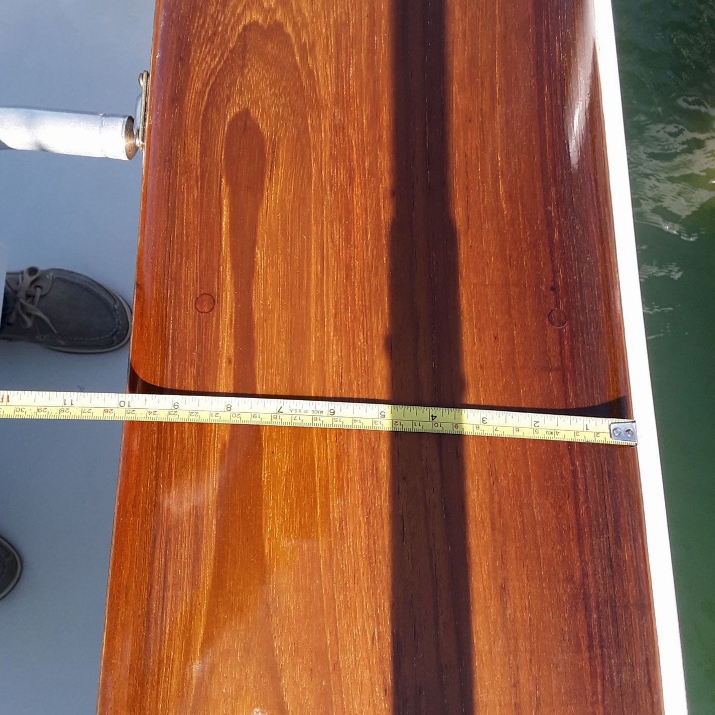

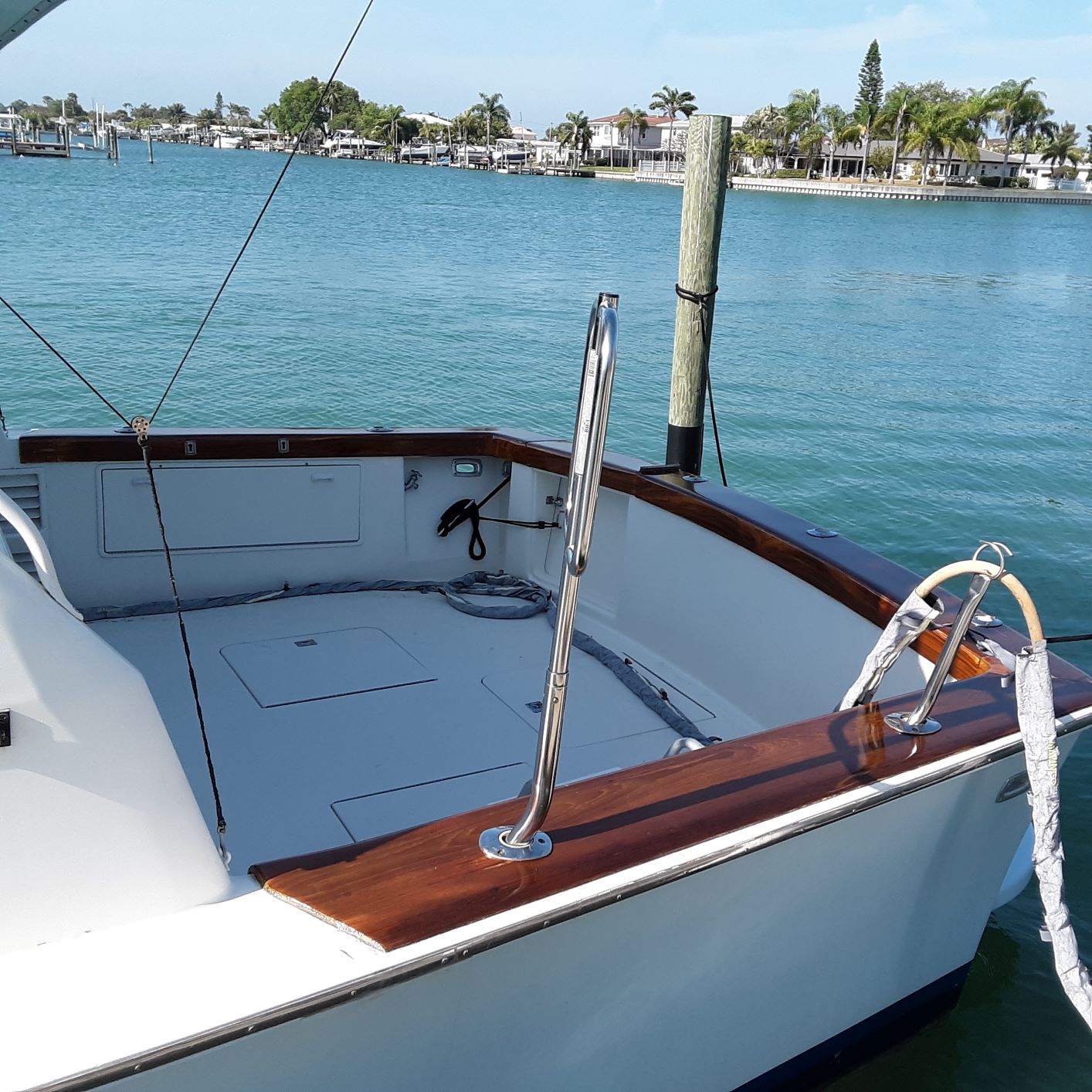

    Just wanted to add my 2 cents worth. I have 1992 42’ Ocean. In Jan 2017, I had the teak sanded down, replaced plugs were necessary, 3 coats of epoxy, 4 coats of varnish. Every 3 months, I have a great guy, do a light sand to break thru the topcoat of varnish and reapply a new coat $100. Photo’s are from just having it done on Friday. I believe the teak is original from when the boat was built. Yes, there are a few cracks, but what do you expect from a 28-year-old boat. Teak is approx. ½” thick, crewed down and probably glued down. If you fish/ you do not want to varnish, it like an ice-skating rink when wet and after doing a king fishing tournament, it did not look to good. Leave it as natural as possible. Will probable have to sand down to the epoxy next year and start over. 20200304_153111.jpg 20200304_153139.jpg 20200304_153554.jpg

    Beautiful, and I think it emphasizes my point. Your teak is fastened to surface not already raised by a glass covering board. Send us some more photos. A lot of Post junkies on this forum.
