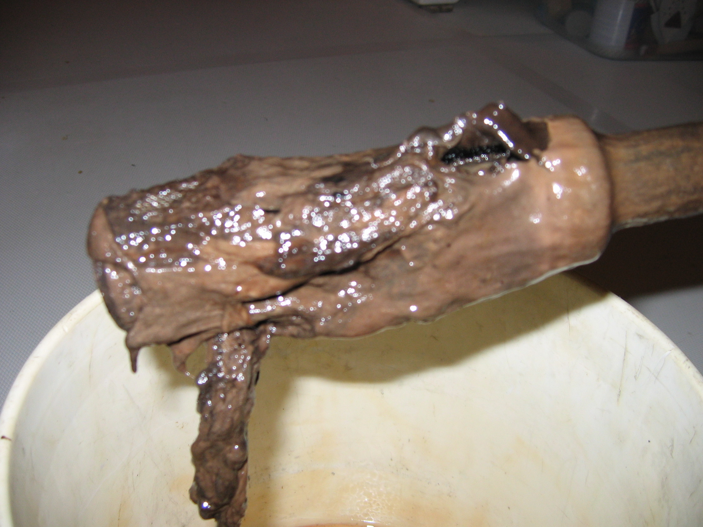

    Based on an other thread regarding fuel tank sizes and usable fuel.
    I started thinking about usable in a tank.
    I wondered how much of these big numbers is usable fuel.
    Always bugged me that the mains fuel pickup is not on the bottom.
    If there is gunk on the bottom of the tank, would you not want that picked up and filtered?
    In rough water, it will get picked up,, at the wrong time.
    I had my pickups up years ago chasing another problem.
    Next time available, I'm extending mains pick ups to the bottom.
    Don't we want to filter all the stuff in our fuel tanks? Before it gets mixed up at the wrong time?
    Potable water is from the bottom to ensure all is fresh?
    Don't we want all fresh fuel in our tanks?
    When possible with separate pick ups, gen-sets are always up higher. Nice to have a reminder your Bingo in case you really mess up.
    Why am I working (again) against the standard way things are done??

  5. Capt Ralph
    12,749
    No.
    You see that pick up screen, we still ran.

  11. Capt Ralph
    12,749
    But if there is fuel under your pick ups, it never gets filtered.
    Stuff is heavier than diesel.
    Use the boat yes, Hit that choppy weather and that bottom stuff gets picked up at the wrong time.
    Maybe I'm typing all of this wrong??
    Are you kids understanding that the stuff under the pick up that never gets cycled? or used?
