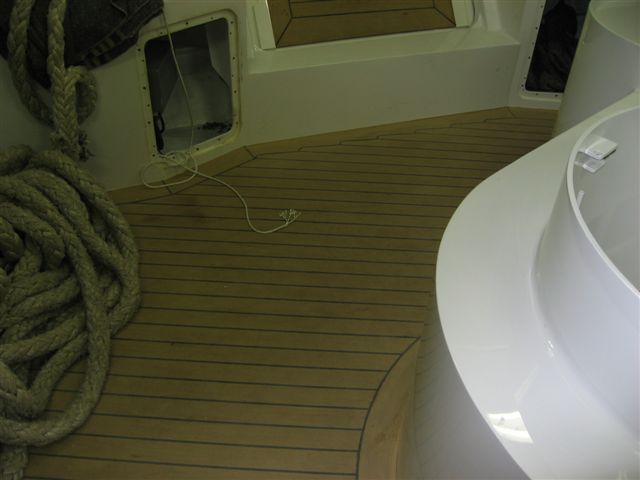

    NYCAP- It is nothing like Non Skid, it looks and feels like teak.
    Here is a picture albeit not a very good one.

  3. K1W1
    7,453
    This stuff does NOT come in sheets it is a poured , sanded, grooves routed into it and caulked to look l and feel like Teak.
