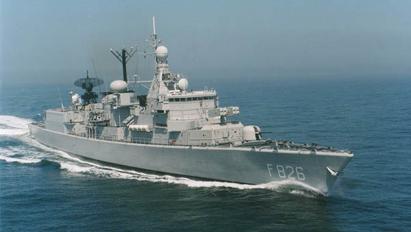

    Hello everyone, I noticed a press release from Dutch technical services company Imtech yesterday, which states that a former Dutch frigate measuring 130 metres will be rebuild/converted and stretched into a 141 metre megayacht.
    Probably a faster way of getting a yacht with such capabilities than building a new one, but if a "normal" wealthy person owns such a ship, I guess all the weapon systems have to be removed prior to the sale?
    But since this frigate is part of the UAE navy, perhaps a ruler is the owner, so some weaponry will stay in place?
    If I'm correct these "Standaard-fregatten" (Standard class frigates) are gasturbine powered, have a top speed of 32 knots, and a draught of over 6 metres (20 ft).

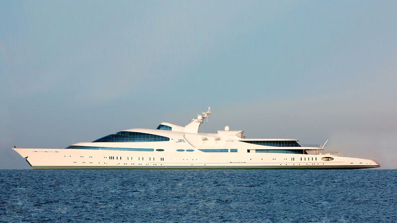

    Here is the mother of all yacht conversions Yas based on the hull of a former navy frigate!

    YAS is based on the hull of an 1978 built Dutch Navy Ship, the HNLMS Piet Hein, a Kortenaer-class frigate of the Royal Netherlands Navy. This ship was sold in 2003 to the UAE and originally equipped with 4 Rolls Royce gas turbines (COGOG propulsion). During the conversion, the gas turbines were replaced with 2 MTU 20V 8000 diesel engines with app. 7.800 KW each. With 141 meter in length and only 15 meters in beam, a very sleek boat. The German Navy used to have several almost identical frigates, the Bremen-class. Our sailors had had a saying about that hull design, "it starts rolling already on a wet lawn". GRP for the superstructure on the yacht conversion was taken for obvious reasons. My oldest son served during his conscript time on one of this frigates. He discribes his state of health at his time of military duty as either seasick or homesick :).
    The conversion (which was more than complex) caused many problems (and a lot of money), not only because the base was a more than 30 year old beaten and abused military ship. Some of the problems were yard and subcontractor related. The drums in the industry are telling, they still have engine problems due to the high raw water inlet temperature in her home waters (Thats why the Navy likes Gas Turbines). Especially the MTU 8000 class engines do not like to be run outside their pretty narrow spec. (Mr. L. Allison could tell a lot about that subject).
    IMHO this yacht had the wrong base to be converted from, the wrong yard for that conversion and some, lets say, less than optimum subcontractors and project management. Filler, paint and fairing allone will not turn a duck into a swan.
    Just my 2 (Euro) cents

    Personal comfort of VIP guests during voyage or on the hook is definately not part of the spec of a military combat vessel :D. Yachts do not have to outturn torpedos or bombs and have to circle around her convoys in order to protect them from subs. Even with the stabilizers added during the conversion, YAS will not be very comfortable, when on anchor in less than calm sea. And I feel very sorry for her deckies, which have to clean her forward superstructure. Not an easy care boat.

    Since we never had an official thread for the "YAS" then here is one. This is one strange vessel that has an interesting history and even more interesting period being converted from a Naval vessel (frigate) that served the Royal Netherlands Navy as well as the Abu Dhabi Navy to a one of a kind bespoke superyacht for a daring owner. For the first time we can watch a fairly in depth video regarding some of the work done and challenges encountered in making this build a reality. Pierrejean Design Studio uploaded this video a few months ago.
