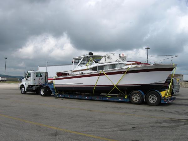

    37' Roamer Loaded on Flatbed
    Just across the Wi/Iowa Border 2 summers ago
    memory is fading but I think it was 13'3" to the slight sitck up of the flybridge control tube which can be seen as the black trash bag on top

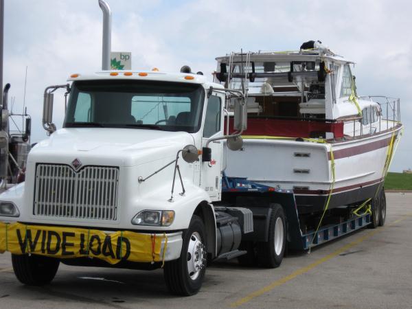

    37 loaded
    Another angle

    Props and rudders were removed and the ends sat very deep in the outboard wells of the trailer.
    AS mentioned memory is fading - ALZ in my future
    trailer beams are 10" and I thought I had it on 12x12 beams but maybe they are 8x8. They are still on trailer so next time I am at boat Ill take pics of set up
