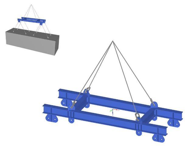

    The worst method is the direct connection of the front and rear sling to a single hook without the integration of load handling attachments. This is prone to sling slippage.
    The integration of a box type beam traverse (see below) will parallel the load and stabilize the slings.
    For our own boats, both work boats and smaller yachts like my 50 ft inland waterway cruiser, which are lifted quite often, we have heavy duty threads built into the deck/frame structure for srew in lifting eyes. Together with customized steel cables and shackles, the boats can be lifted safely as often as wanted.

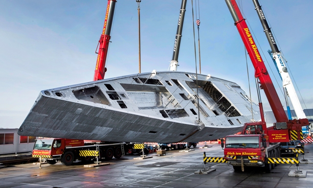

    It is common practice in most yards, when welding large aluminum hulls for sail boats for example, they are built upside down. After having set up frames and stringers precisely, the skin can be welded to the skeleton far more accurate and with far less distortion in this upside down position.
    But at a certain stage of the build, the casko has to be turned into the upride position. This is a very critical point during the building process. Most sheds are not big enough for this turning maneuver. So, it has to be done outside and on a level and paved area in front of the shed or on a barge and mostly with multiple uge road cranes.
    We are working in our heavy outsized cargo moving world a lot with those road crane operators. This guys are the greatest professionals one could think of. Moving, turning and lifting of uge and heavy loads to a new position within a fraction of an inch and this simultaneously with multiple massive road cranes, is a great job.
    I have seen real big men sweating and getting nervous on these occasions. But most of the time it is the yard owner and the project manager and may be the guy from the insurance company but not those pros on their joysticks :).

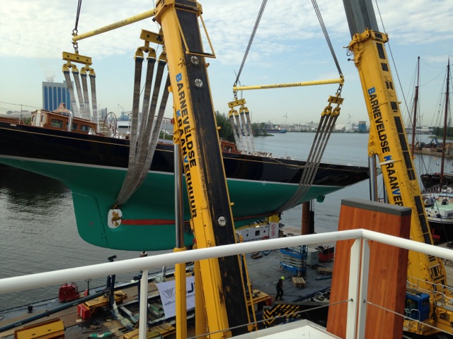

    Here is a photo of J8 that was launched a few days ago. This is roughly a 140 foot yacht to give you an idea of scale. Check out the way this was lifted and strapped. J8.jpg
  14. HTMO9
    HTMO9 Senior Member
    Jan 13, 2009
    1,681
    Well done.
    A J-class hull is most probably one of the most dificult piece of yacht to be sling liftet. Everything is sloped.
    Aft sling in the prop cutout in the keel, forward sling horizontally secured, retractlable bow thruster deployed as a last ditch, if something goes wrong. Most likely the best way of doing it, if a cradle lauch was not possible. Quite a task!

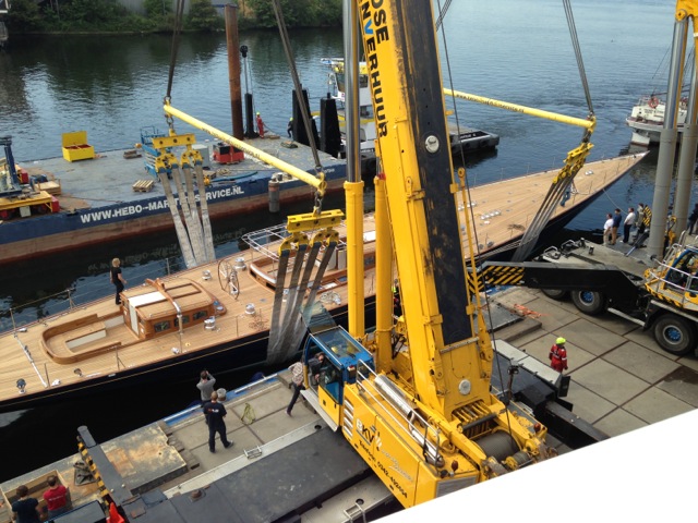

    IMG_2851_2.jpg safe and sound

    Did they need a diver, in order to remove the rear sling?
    Oh, I see it came from HJB via the barge and was lowered to the water in the harbour.
  17. Marblehead01945
    Marblehead01945 Member
    Jul 25, 2008
    104
    Marblehead
    I actually don't know. I would imagine so if they didn't want to risk harming the prop or the sling.

    That hull turning took place at the premises of casko builder Bloemsma & van Breemen in Makkum, NL. I think, they took a pretty high risk during that maneuver and they were pretty lucky, that everything went well. Even only being a few inches above the ground, that empty hull, dropped on the floor, would have been damaged beyond repair.
    Professionalism looks different.
